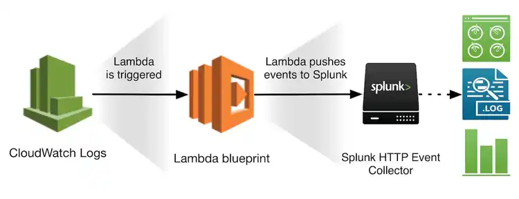

At AWS re:Invent 2016, Splunk released several AWS Lambda blueprints to help you stream logs, events and alerts from more than 15 AWS services into Splunk to gain enhanced critical security and operational insights into your AWS infrastructure & applications. In this blog post, we’ll walk you through step-by-step how to use one of these AWS Lambda blueprints, the Lambda blueprint for CloudWatch Logs, to stream AWS CloudWatch Logs via AWS Lambda and into Splunk for near real-time analysis and visualization as depicted in the diagram below. In the following example, we are interested in streaming VPC Flow logs which are stored in CloudWatch Logs. VPC Flow logs capture information about all the IP traffic going to and from network interfaces, and is therefore instrumental for security analysis and troubleshooting. With that said, the following mechanism applies to any logs stored in CloudWatch Logs.

The pipeline stage prior to Splunk HEC is AWS Lambda. It will be execute by CloudWatch Logs whenever there are logs in a group, and stream these records to Splunk. Luckily, there’s already a Lambda blueprint published by Splunk for exactly that purpose.

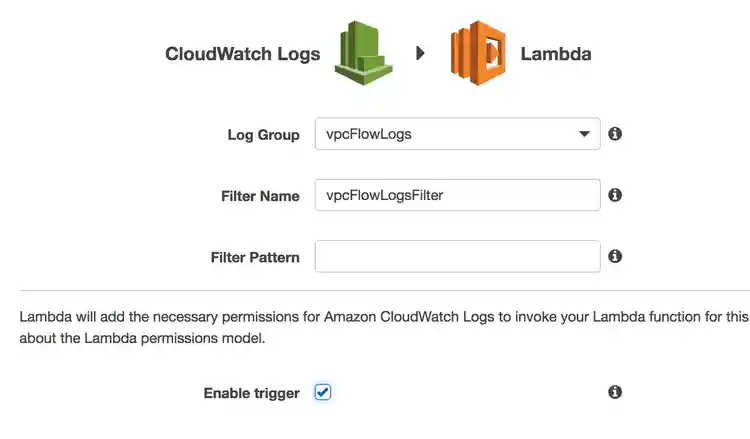

3b. Configure Lambda function trigger. Select ‘CloudWatch Logs’ as trigger if it’s not already selected. Then specify vpcFlowLogs as the log group. Enter a name for ‘Filter Name’, say vpcFlowLogsFilter. You can optionally enter a value for ‘Filter pattern’ if you want to restrict what gets delivered to Lambda. Before clicking ‘Next’, make sure ‘Enable trigger’ is checked. This is an example of how this form would look like:
Add trigger for Lambda function
This is also known as a CloudWatch Logs subscription filter which effectively creates a real-time feed of logs events from the chosen log group, in this case vpcFlowLogs.
Note that, when adding this Lambda trigger from the AWS Console, Lambda will add the required permissions for CloudWatch Logs service to invoke this particular Lambda function.

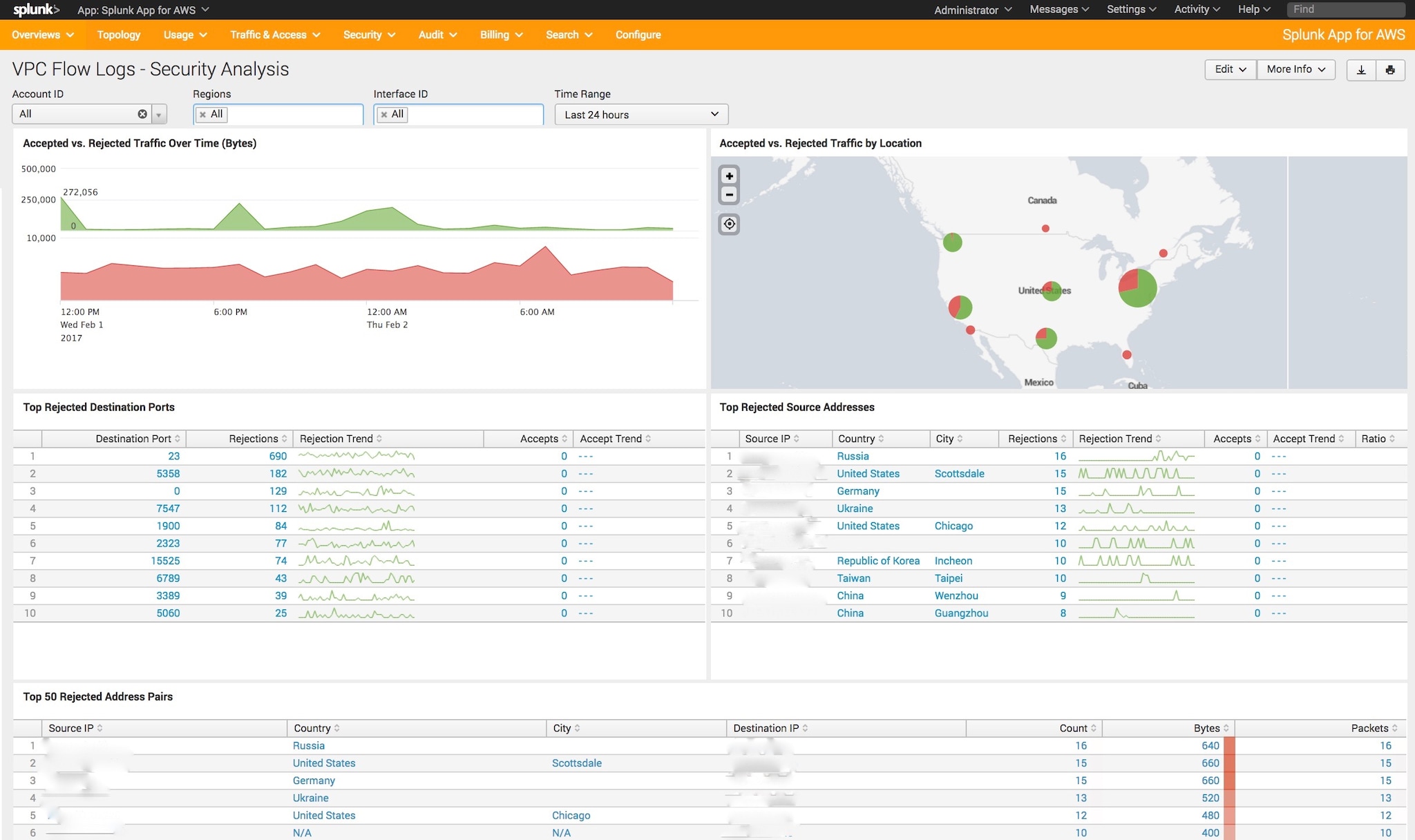

By using Lambda-based data ingestion, not only you can benefit from the simple setup above, but you can also leverage the advanced dashboards & sophisticated traffic & security analysis of VPC flow logs that come with Splunk App for AWS. If you set the correct sourcetype, for example “awsvpcflow” in the case of VPC Flow logs as shown above, then you should see relevant dashboards populate automatically. Once installed, navigate to Splunk App for AWS, and view “VPC Flow Logs: Traffic Analysis” dashboard under Traffic & Access dropdown menu and “VPC Flow Logs: Security Analysis” dashboard under Security dropdown menu:
VPC Traffic Analysis
VPC Security Analysis
