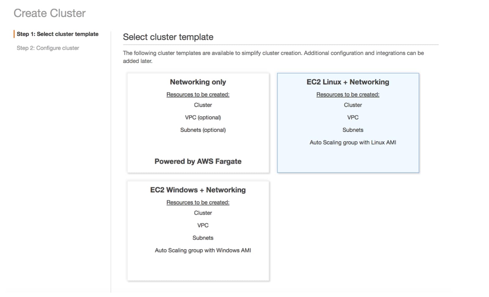

Navigate to ECS in your AWS Console and a Create Cluster – we will use the “EC2 Linux + Networking” option here.
Now run through the cluster settings. This will include EC2 instance type for the containers, number of instances in the cluster, networking etc. For the purposes of this blog, we’ll take most of the defaults, excluding:
