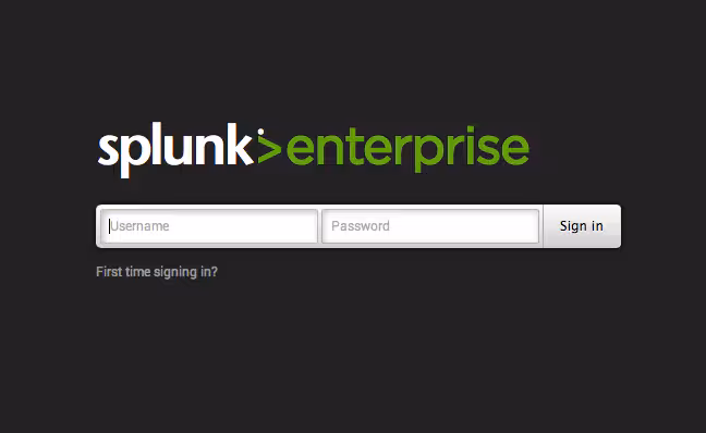

First, download Splunk 6 from our download site. Install using the documentation and default settings. Once Splunk is installed, you should open a browser and go to http://localhost:8000. You will be presented with a login page. For the first login use the username “admin” and password “changeme”.
Once you login, you will see a popup describing new features in Splunk 6. Close this out and you will be ready to configure!
