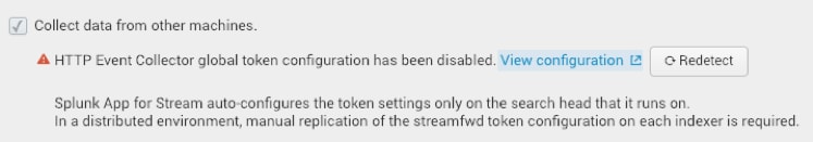

After logging in to your Splunk Stream server, from the configuration page of Splunk Stream, click the “Collect data from other machines” button. You will need to enable the HTTP Event Collector first if you're going to use the Independent Stream Forwarder at a later stage (but if only using Universal Forwarder for forwarding, then you won’t need this):

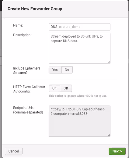

Now you have a stream configured, go to “Distributed Forwarder Management” under the configuration menu and create a new group:
Choose which forwarders to deploy to using regex to define a group, if required.
Now choose which streams to capture under this new group configuration.
