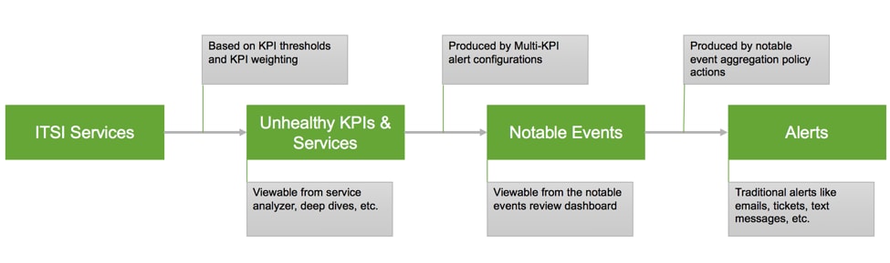

Thresholds vs. Alerts Let’s first clarify the difference between thresholds and alerts—in ITSI, these are related but separate concepts. Thresholds apply only to KPIs; they dictate when a KPI severity (or status, as they are sometimes referred) changes from normal to critical, high, low, etc. KPI severities are viewable in the service analyzer dashboard, deep dives, and other UI locations, but in and of themselves don’t generate alerts.
Alerts are generated from additional configurations, driven from KPI severity and service health score changes. We’ll dig in to these configurations later, but for now, we just want to acknowledge the difference between the two concepts.
Alerts vs. Notable Events At the risk of being pedantic, what is an alert anyway? Is it an email? A text message? A ticket to a ticketing system? A flashing red light in the NOC? Something else? Within ITSI, we take a two-tiered approach to generating alerts. Notable events are created first, which then lead to one or more traditional alerts. We configure ITSI to continuously monitor KPI statuses and service health scores; when we detect problems or concerns, we can then create notable events.
Notable events are not alerts—at least in the traditional sense—they are simply events of interest viewable from the Notable Events Review dashboard. It's a separate and final configuration using notable event aggregation policies that turn one or more notable events into your traditional alerts like emails, tickets, etc. Put the process all together and it looks like this:

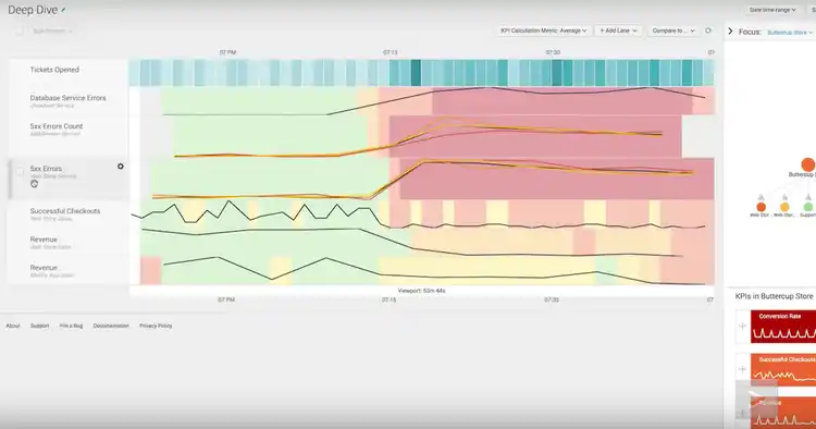

Deep dive threshold validation Deep dives display the computed KPI severity and also allow you to look back in time (at least for as long as the KPI has been defined and backfilled). What makes this awesome is that you can tune the threshold, return to the deep dive view and upon refreshing see the results of the new threshold configurations.
Work KPI by KPI using this method to validate the threshold results as thoroughly as you can. Here is where you want to validate that your organization's status definitions are being met. Again, if critical is going to trigger a page out in the middle of the night, you better be working to validate that you’re not seeing high volumes of unwarranted critical status KPIs.
A Deep Dive GOTCHA!
Sooner or later, you're going to get tripped up with the information you see in the deep dive. Remember that your KPI is running every 5 or 15 minutes; that's producing a lot of data points over time. So many data points in fact that, as you expand the deep dive time window, ITSI will visually aggregate those many KPI results into larger blocks of time.
To better illustrate this, the screenshot below graphs both the actual number of data points in a 24 hour period for a KPI running every 5 minutes, and also the summarized graph you'd see in a Deep Dive over the same 24 hours. As you can see, the deep dive summarization "hides" the peaks and valleys of the actual data unless you zoom in your time window enough. When summarization occurs, the KPI calculation metric selector at the top of the screen flexes the type of visual summarization you see over that block of time.
In short, when validating KPI thresholds, be sure to select small enough windows of time to ensure you're seeing the full granularity of the result history, or flex the KPI aggregation metric to the function that will best display the historical outliers for you to accurately validate KPI thresholds.
Compare with a recent past incident While in the deep dive validating a KPI, it would behoove you to refer back to some recent incidents associated with the service. Use the time picker in the upper right to go back to when the incident first began. For instance, if you recently had a system problem affecting the ability for users to log in, you should clearly be able to see the login KPI go high or critical at the start of the incident, or see some other related KPI go critical around that time.
If everything remains green or doesn’t appear to rise to an alarm level, it could indicate your thresholds are too forgiving or that you're running across the deep dive gotcha described above.
