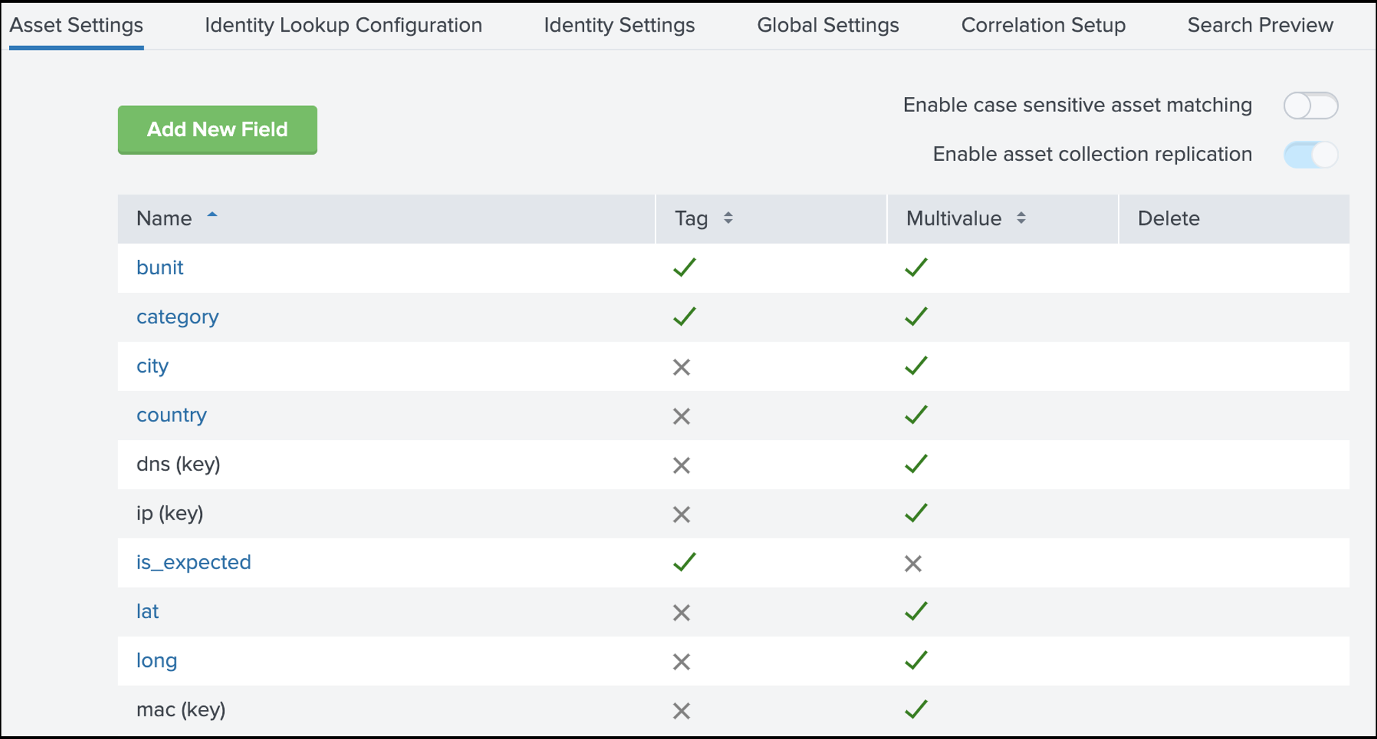

If we want to add additional fields to our assets, we can click on the Asset Settings tab where we can view all of the current asset fields. These will include the fields that you are already familiar with like ip, nt_host, country, bunit and more.
To add an additional field, click on the green button at the top of the screen and a New Asset Field window will pop-up. For this example, we will enumerate the specific racks where our systems reside. To do this, we can add a field called rack_number and click Save. If we wanted the field to be multi-value or used as a tag, we have that option as well. We can add up to 20 additional fields to both assets and identities.

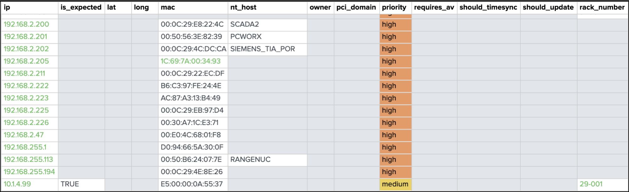

If we click on the frothly_assets_2019 under the column Source, we can see a tabular view of the supporting source data. Sadly, this asset data does not have a rack_number in it. We will add that column in a moment, but for now, I am more interested in the Thirsty Berner ICS Assets, which if I click into, I can see that I have the column rack_number already defined and populated for some assets.
We can see that 10.1.4.99 has a rack number of 29-001. When the two lists converge, even though I don’t have the field rack_number in frothly_assets_2019, the rack_number from Thirsty Berner ICS Assets is returned in the converged asset record and if you look closely, you will notice that the priority from frothly_assets_2019 came across because it has a higher rank over the medium priority in Thirsty Berner ICS Assets. This was something we covered in our first blog on asset & identity framework if you recall, Steven.
