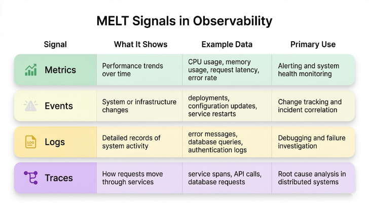

The four signals of MELT
Each signal contributes a distinct layer of insight into the system’s health and security posture. MELT groups four core telemetry signals used in observability:
  1. Metrics show system performance trends over time.
  2. Events record changes that occur in the system.
  3. Logs capture detailed records of system activity.
  4. Traces show how requests move across services.
Metrics
Metrics are numerical measurements that track how system behavior changes over time. They are collected continuously from applications and infrastructure and are typically visualized on dashboards or used to trigger alerts.
Common examples of metrics include:
Because metrics are easy to aggregate and monitor in real time, they often provide the first indication that something is wrong in a system.
For example, an API might normally respond in 200 milliseconds. If response times suddenly increase to 1.5 seconds, a latency metric immediately surfaces the performance regression. At this stage, engineers know a problem exists, but additional signals are usually needed to understand the cause.
Events
Events represent discrete occurrences within the system. Unlike continuous metrics, events are snapshots of change—such as a container deployment, a configuration update, a service restart, or an auto-scaling event. Events provide the critical "timeline" context that helps engineers correlate system degradation with recent changes. Some of the most common events include:
Imagine a deployment occurs at 2:00 p.m. Shortly afterward, error rates begin to increase. By looking at the event timeline, engineers can quickly connect the spike in errors to the recent release.
Logs
Logs are the most granular source of truth. They provide a timestamped record of specific actions or errors within an application. A log entry might contain a stack trace, a database query error, or a failed authentication attempt. Logs are essential for forensic analysis, allowing teams to reconstruct the exact sequence of events that led to a failure or a security breach.
Logs capture detailed records of what happens inside applications and infrastructure. Logs are the most granular source of truth and log entry represents a specific event or action, often including timestamps, error messages, and contextual data.
Logs commonly include:
A log entry might show up like this: Database connection failed: timeout
This type of message can reveal the exact failure that triggered an application issue. Logs are essential for forensic analysis, allowing teams to reconstruct the exact sequence of events that led to a failure or a security breach.
Traces
Traces track the journey of a single request as it traverses through multiple microservices, databases, and APIs. In a distributed system, a single user action may trigger dozens of internal calls. Traces visualize this path, making it possible to identify which specific service is introducing latency or failing to return a valid response. A simplified trace might look like this:
User request → API gateway → payment service → database
If a request becomes slow or fails, traces help engineers identify which service introduced the delay or error.
