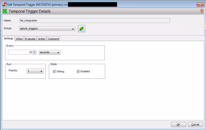

7. Open the OMNIbus Administrator Suite.
8. Check your OMNIbus trigger group (validate that you have a splunk_trigger that is enabled).
9. Check your OMNIbus trigger (validate you have an itsi_integration trigger that is enabled).
10. Adjust the temporal trigger details. For example, you might only send data to Splunk after Netcool has enriched the data or after the impact policy completes and an impact status is set.
11. Adjust the Netcool User and Group ID in the procedure details.
Note: You can change the list of fields that are sent to ITSI in the Arguments section. The integration script immediately picks up the field list.
