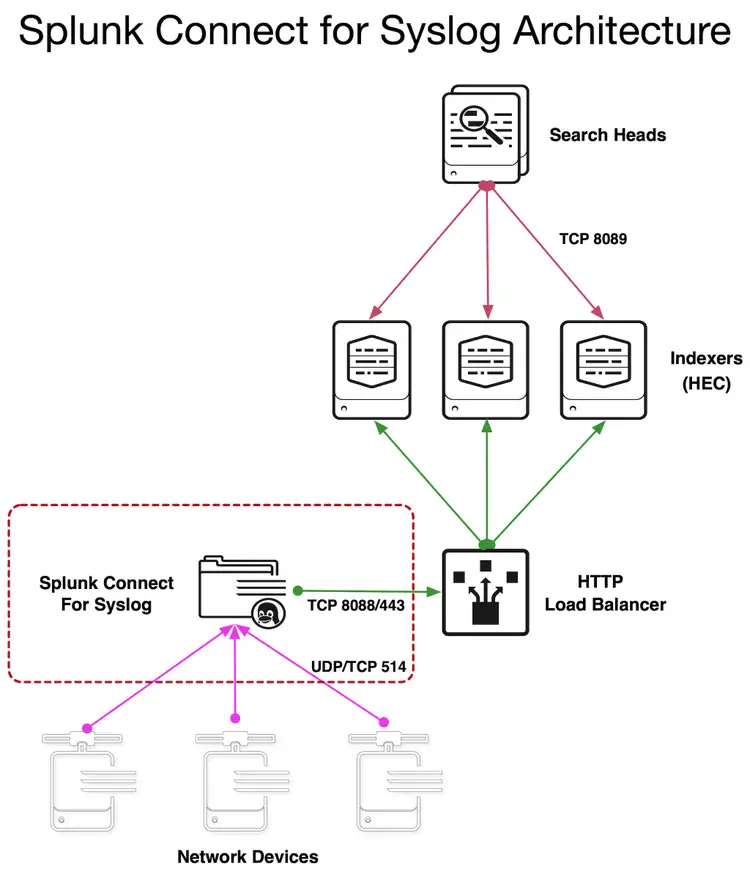

Splunk Connect for Syslog Architecture
To realize the above benefits, SC4S is offered in two flavors: An OCI-compliant container for ease of deployment and OOTB functionality, and a “Bring Your own Environment” (BYOE) option for maximum flexibility at the expense of some turnkey features. Each environment is based on syslog-ng server software and encapsulates the same set of syslog-ng server configurations, while differing on the details of how syslog-ng itself is instantiated. Each utilizes the following high-level architecture:
Here are the highlights of each distribution:
Container
- The SC4S “easy button”
- Includes the latest stable branch of Syslog-ng server
- All templating software included and automatically invoked at startup
- Local disk buffer for data resiliency
- Housed on the Red Hat Linux Universal Base Image (UBI) – super lightweight Linux designed for use in containers (the standard across all Splunk container projects)
- OCI-compliant and compatible with the runtime of your choice (Docker, Podman, k8s, etc.)
BYOE
- For customers with bespoke requirements
- For customers unable to use containers for any reason
- Provides full access to underlying syslog-ng config files
- Requirements
o CentOS or RHEL 7.0 or later linux distro
o Latest syslog-ng; 3.24.1 as of this writing
o Latest gomplate templating software; version 3.5 or later (this is not necessary at runtime)
In each distribution, the underlying syslog-ng configuration is identical; the differences between container/BYOE lie solely in the customer’s preference (and limitations) as to runtime environments. Moreover, a customer utilizing a “BYOE” environment can build a custom container that includes local config elements, which would then be suitable for edge distribution by automated orchestration.
