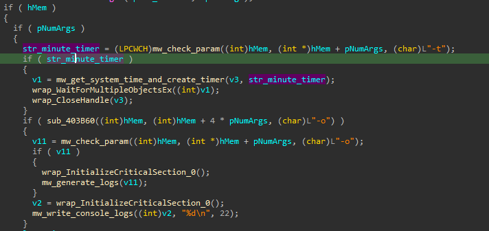

Parameter Check
The first part of its code is checking parameters that can execute some of its features related to timing and logging. Below is the code screenshot of this checking with its 2 parameters.
The first parameter is “-t” which will trigger a waiting timer relative to the current minute of the system time. For example, if your system time is 14:19:22 PM and you use this parameter with a value of 25 as the third parameter, it means it will wait 5 mins before it executes its code like the screenshot below.
While the “-o” parameter is a feature to redirect its console logs to a debug log file you inputted as the 3rd parameter.

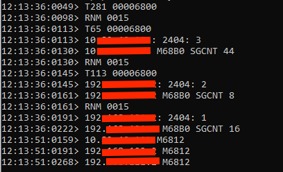

Console Logs
Upon executing this malware, it outputs some console logs with a customized code structure that tells something about what features it executes. Some of it will be discussed further in the next subheadings. Below is an example of the console logs during its execution.

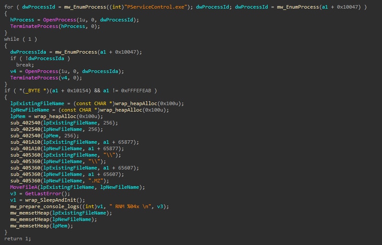

Terminate Process and Rename Process File Path
This function enumerates all running processes in the targeted host and looks for the process named “PServiceControl.exe” and also the process name stated in its config data. It will also look for the file path of that process in a specific folder that is in the config file and rename it with “.MZ” file extension.
The code screenshot below shows the process termination and renaming of process file path. We can see in the code snippet the code “RNM” plus the last error code after the call MoveFileA() function that will be displayed in its console logs after executing this part of the code. You can see that in the console log screenshot earlier.

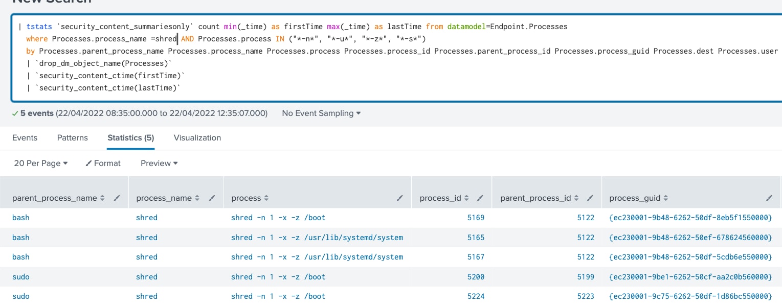

Linux Shred Overwrite Command
This analytic identifies a shred process to overwrite files in a linux machine. Shred Linux application is designed to overwrite a file to hide its contents or make the deleted file unrecoverable.
| tstats `security_content_summariesonly` count min(_time) as firstTime max(_time) as lastTime from datamodel=Endpoint.Processes
  where Processes.process_name =shred AND Processes.process IN ("*-n*", "*-u*", "*-z*", "*-s*")
  by Processes.parent_process_name Processes.process_name Processes.process Processes.process_id Processes.parent_process_id Processes.process_guid Processes.dest Processes.user
  | `security_content_ctime(firstTime)` | `security_content_ctime(lastTime)`

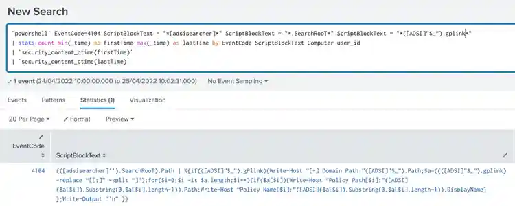

Windows Root Domain Linked Policies Discovery
This analytic utilizes PowerShell Script Block Logging (EventCode=4104) to identify the `[Adsisearcher]` type accelerator being used to query Active Directory for domain groups. Red Teams and adversaries may leverage `[Adsisearcher]` to enumerate root domain linked policies for situational awareness and Active Directory Discovery.
`powershell` EventCode=4104 ScriptBlockText = "*[adsisearcher]*" ScriptBlockText = "*.SearchRooT*" ScriptBlockText = "*([ADSI]”$_”).gplink*"
  | stats count min(_time) as firstTime max(_time) as lastTime by EventCode ScriptBlockText Computer user_id
