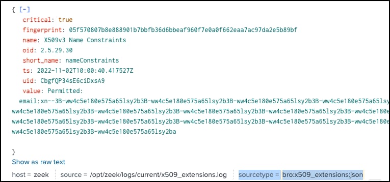

This script uses the base X.509 Zeek functions, but then looks for any extensions within certificates, and if found, logs the following fields as shown here in a Name Constraints extension event.
Fig 4. X.509 Name Constraints Extension Event
I’ve included a few other fields here to help correlate with other Zeek data.
