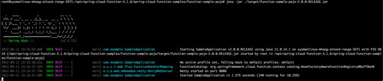

java -jar ./target/function-sample-pojo-2.0.0.RELEASE.jar
After the application is up and running, the user can now use the Metasploit module.

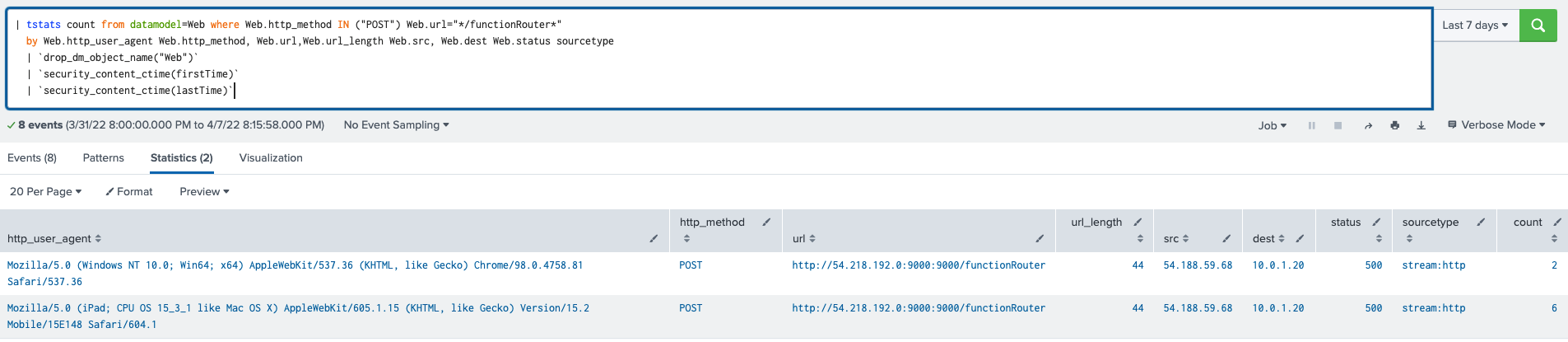

The following analytic was generated in relation to CVE-2022-22963. It identifies the POST to the URI path of /FunctionRouter. Depending on the environment, this analytic may not be noisy. We’ve found across a large dataset this has only generated notables based on scanning looking for the vulnerability.
| tstats count from datamodel=Web where Web.http_method IN ("POST") Web.url="*/functionRouter*" by Web.http_user_agent Web.http_method, Web.url,Web.url_length Web.src, Web.dest Web.status sourcetype

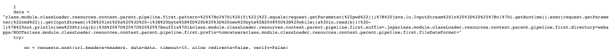

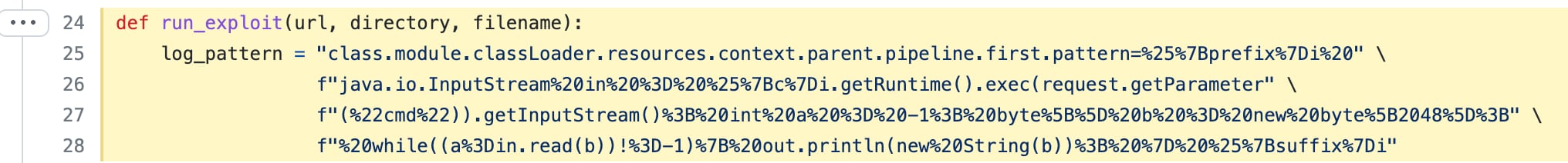

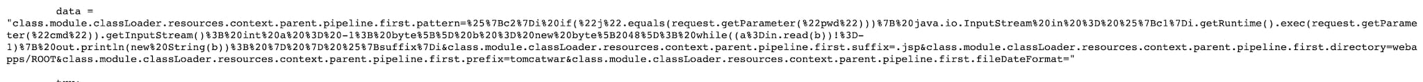

The top 3 samples reviewed all have the same pattern for the exploit that will be passed to the web server.

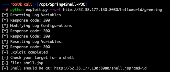

Exploit The following sample was used to validate the vulnerability https://github.com/reznok/Spring4Shell-POC . Each attempt worked and a shell.jsp was written to disk and by visiting the site a response would be provided.

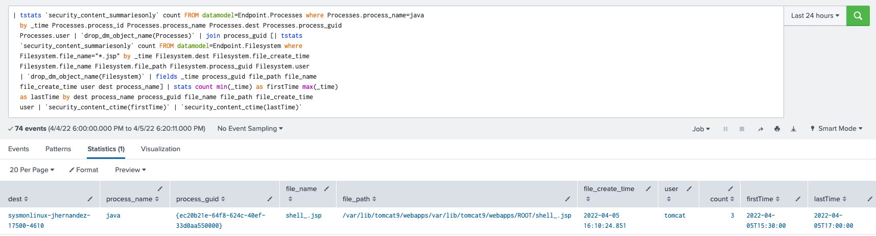

Java Writing JSP File Upon successful exploitation, a new jsp file is created within the web app directory. The following analytic identifies the process and path of the new file on disk. The POCs provide the ability to name the file anything, but there are some standard filenames (covered in Spring4Shell Payload URL Request).
| tstats `security_content_summariesonly` count FROM datamodel=Endpoint.Processes where Processes.process_name IN ("java","java.exe", "javaw.exe") by _time Processes.process_id Processes.process_name Processes.dest Processes.process_guid
