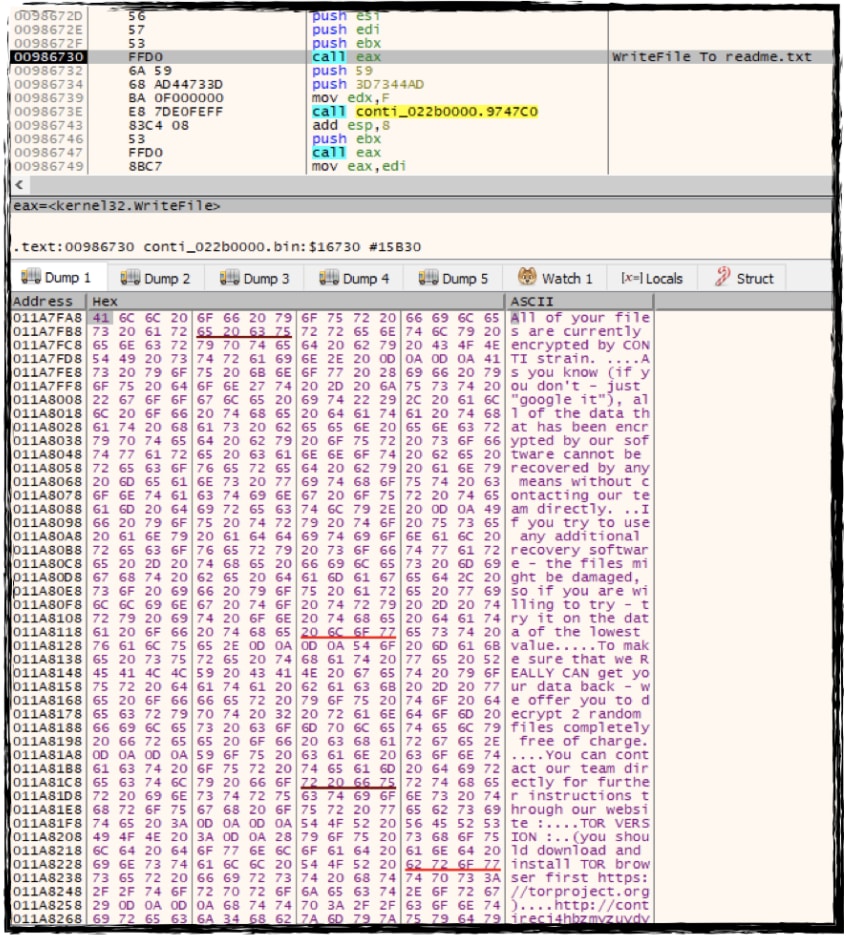

In the following graphic, the victim is asked to upload readme.txt created by the Conti ransomware payload.

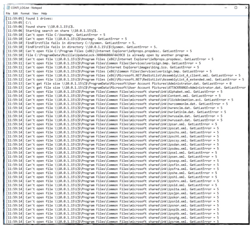

Log File: Below is the screenshot of a Conti log file generated as you use the -log feature.

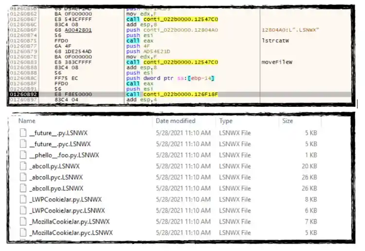

In the Conti sample we have analyzed, we found that it uses the “.LSNWX” file extension for all files it will encrypt in either/both local drive and network share. Below are screenshots of its code creating .LSNWX files, as well as some files getting encrypted.
Below is the screenshot of a log file generated with -m full parameter.
Conti code as it generates the ransomware notes on the affected directory, root drive or network share.

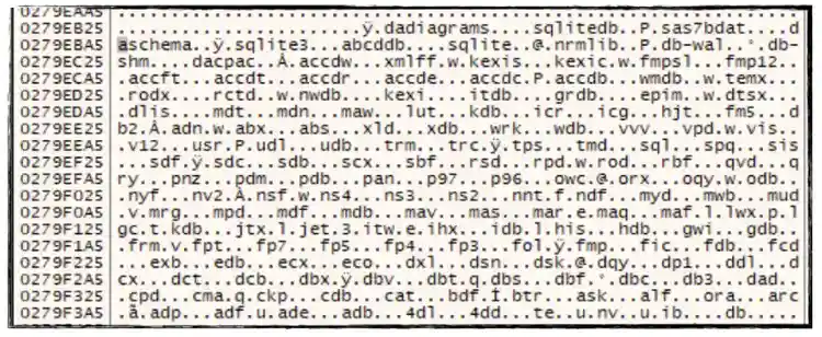

Targeted File Extensions: We also found several file extensions decrypted by this ransomware in memory for small and big files that it wants to encrypt. Below is the screenshot of memory as well as the complete list of the file extensions.
".4dd", ".4dl", ".accdb", ".accdc", ".accde", ".accdr", ".accdt", ".accft", ".adb", ".ade", ".adf", ".adp", ".arc", ".ora", ".alf", ".ask", ".btr", ".bdf", ".cat", ".cdb", ".ckp", ".cma", ".cpd", ".dacpac", ".dad", ".daschema", ".db", ".db-shm", ".db-wal", ".db3", ".dbc", ".dbf", ".dbs", ".dbt", ".dbv", ".dbx", ".dcb", ".dct", ".dcx", ".ddl", ".dlis", ".dp1", ".dqy", ".dsk", ".dsn", ".dtsx", ".dxl", ".eco", ".ecx", ".edb", ".epim", ".exb", ".fcd", ".fdb", ".fic", ".fmp", ".fmp12", ".fmpsl", ".fol", ".fp3", ".fp4", ".fp5", ".fp7", ".fpt", ".frm", ".gdb", ".grdb", ".gwi", ".hdb", ".his", ".ib", ".idb", ".ihx", ".itdb", ".itw", ".jet", ".jtx", ".kdb", ".kexi", ".kexic", ".kexis", ".lgc", ".lwx", ".maf", ".maq", ".mar", ".mas", ".mav", ".mdb", ".mdf", ".mpd", ".mrg", ".mud", ".mwb", ".myd", ".ndf", ".nnt", ".nrmlib", ".ns2", ".ns3", ".ns4", ".nsf", ".nv", ".nv2", ".nwdb", ".nyf", ".odb", ".oqy", ".orx", ".owc", ".p96", ".p97", ".pan", ".pdb", ".pdm", ".pnz", ".qry", ".qvd", ".rbf", ".rctd", ".rod", ".rodx", ".rpd", ".rsd", ".sas7bdat", ".sbf", ".scx", ".sdb", ".sdc", ".sdf", ".sis", ".spq", ".sql", ".sqlite", ".sqlite3", ".sqlitedb", ".te", ".temx", ".tmd", ".tps", ".trc", ".trm", ".udb", ".udl", ".usr", ".v12", ".vis", ".vpd", ".vvv", ".wdb", ".wmdb", ".wrk", ".xdb", ".xld", ".xmlff", ".abcddb", ".abs", ".abx", ".accdw", ".adn", ".db2", ".fm5", ".hjt", ".icg", ".icr", ".kdb", ".lut", ".maw", ".mdn", ".vdi", ".vhd", ".vmdk", ".pvm", ".vmem", ".vmsn", ".vmsd", ".nvram", ".vmx", ".raw", ".qcow2", ".subvol", ".bin", ".vsv", ".avhd", ".vmrs", ".vhdx", ".avdx", ".vmcx"
