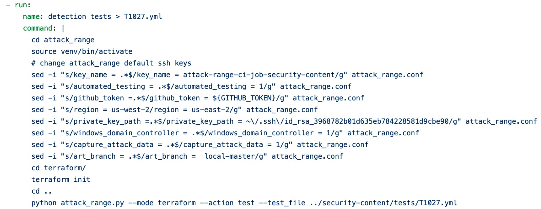

The final piece in our plans was generating CircleCI jobs for each of these test files that executed the above process. For this, we created a simple script called ci-generate.py that would read in every file under the /test folder in Security Content and create a CircleCI task from the file under the CircleCI job test-detections. The task looks like this:
