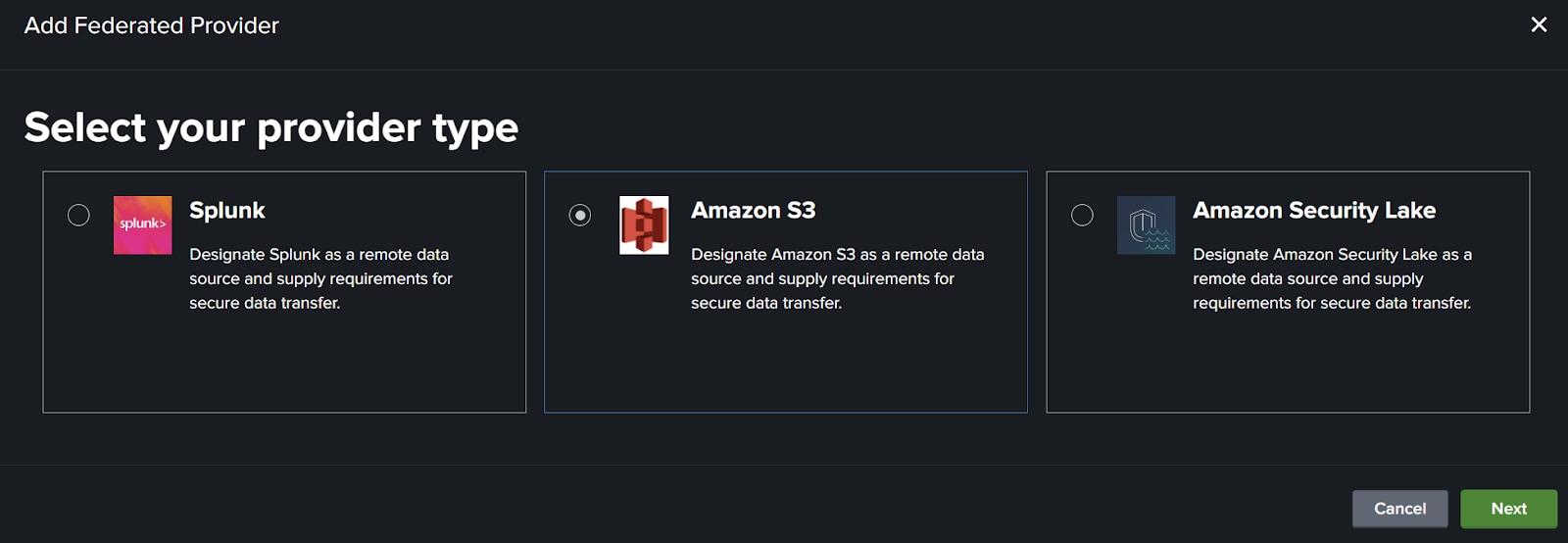

  3. Select Amazon S3 and click next:

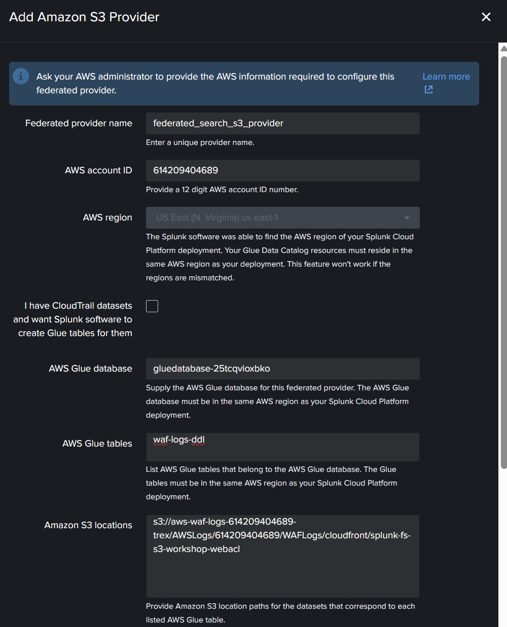

4. On the next page fill out the following items:
Example screenshot of filled in data:
5. Once all of those settings are filled in. Click the Generate Policy Button.

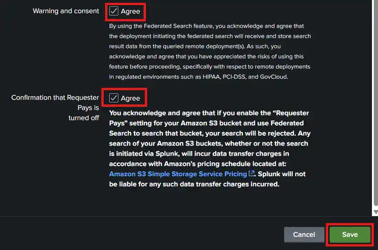

12. Now that we have setup the permissions of Splunk, tick both the agree buttons and Click Save:

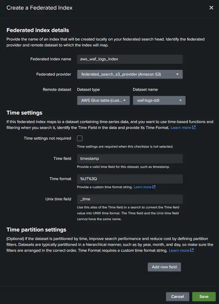

Set Up a Federated Index
  1. Select the federated indexes tab in Splunk
  2. Click the Add federated index, followed by For S3 provider buttons.

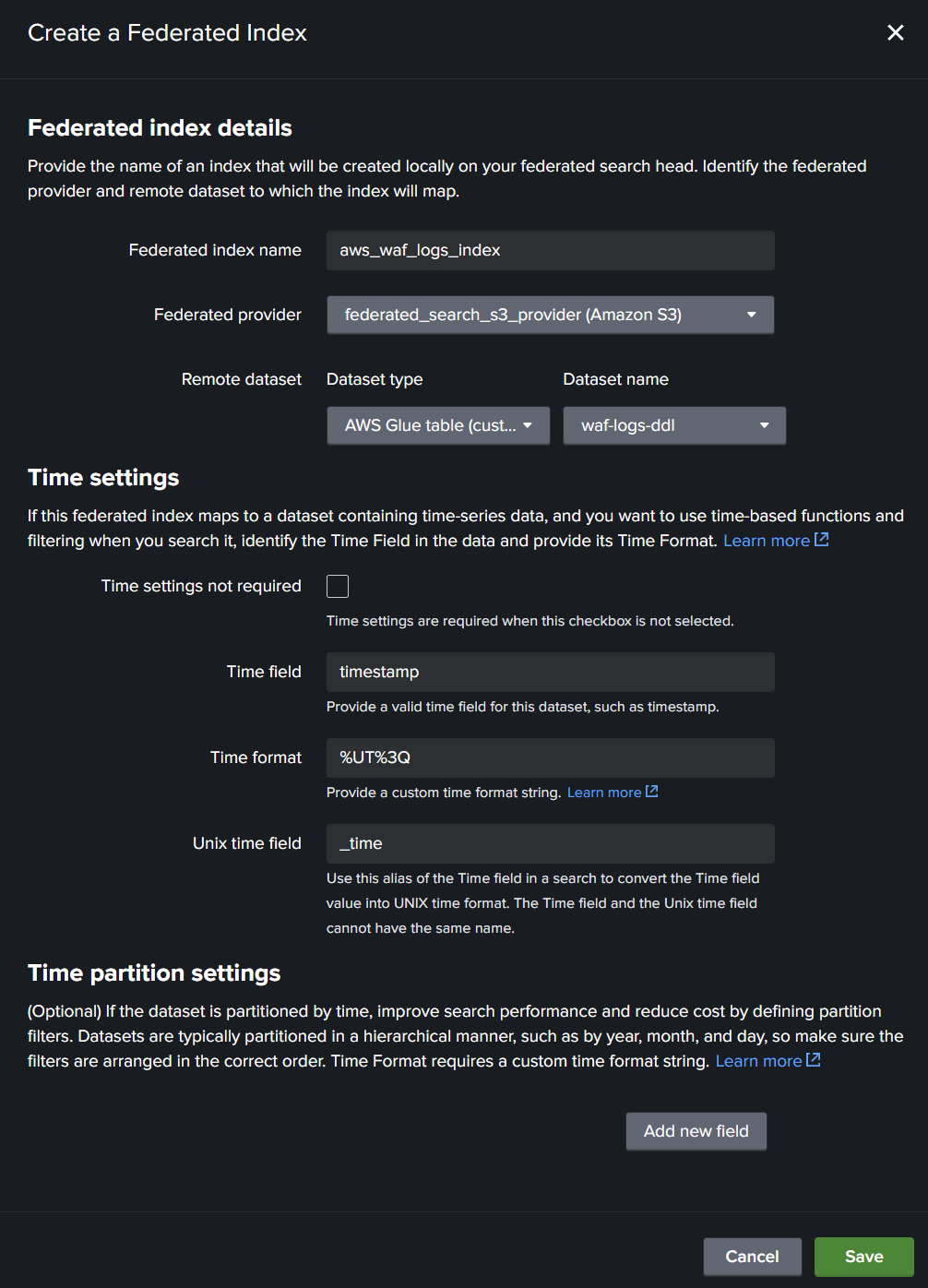

  3. Fill in the following fields to create an index:
    • Federated index name: eg aws_waf_logs_index
    • Select our new Federated Provider we created
    • Dataset type: Make sure (customer created) is selected
    • Dataset Name: Select our glue table name created earlier eg waf-logs-ddl
  4. Fill in the following fields to Time Settings:
    • Time settings not required: Leave unticked
    • Time field: timestamp (this is the timestamp field from AWS WAF logs)
    • Time format: %UT%3Q (this is UNIX time with millisecond format)
Sample screen shot with fields filled in:
Click Save when happy.

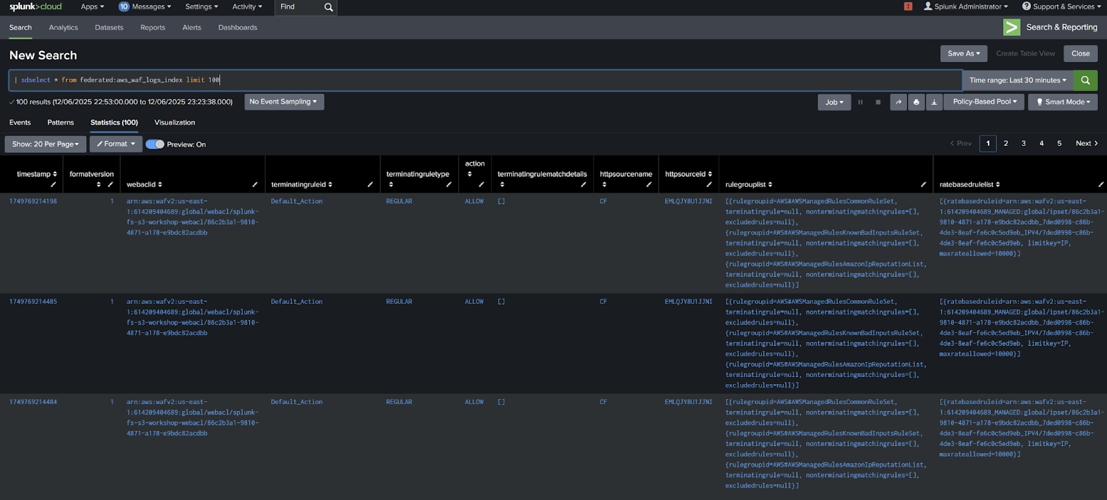

  2. From your search bar, let’s try a simple search. Copy and paste the below SPL into the search bar and click search:
| sdselect * from federated:aws_waf_logs_index limit 100
Note: it may take a minute or two for the permissions to propagate properly. But after a minute or two you should hopefully see the following result as an example:
That’s it! You have now configured a connection between Splunk and AWS to search in place your AWS WAF Logs.
