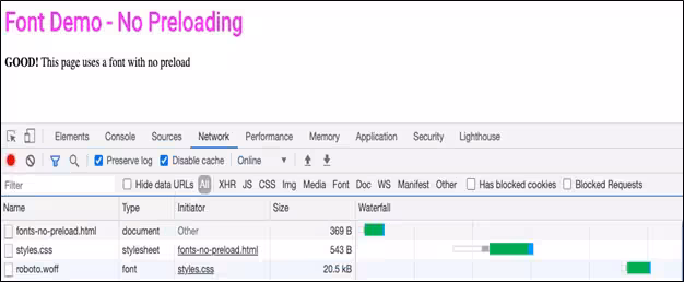

Let’s start with a simplified example, shown in this waterfall diagram:
The browser first downloads the HTML document, which references a stylesheet style.css. Inside the stylesheet, we specify a custom font that should be used, as shown below:
This is a perfect example of a late-discovered resource. This browser doesn’t know it needs to request roboto.woff until it finishes downloading and parsing style.css. We can confirm this by looking at the Initiator column in the waterfall, which tells us what file caused the browser to make the request. The HTML document has an initiator of Other because we typed it into the address bar. The initiator for style.css was the HTML document since the browser found the <link> tag in the HTML. The initiator roboto.woff was the CSS file since the browser found the @font-face declaration for a style in the CSS file that was used in the HTML.

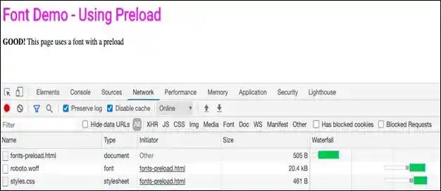

We can optimize this by adding a preload resource hint in the <head> of the HTML file:
<link rel="preload" href="resources/roboto.woff" as="font" crossorigin="anonymous" />
This instructs the browser to proactively download roboto.woff, and creates this waterfall:
There are many things to note:
- The browser now downloads roboto.woff in parallel with style.css.
- The initiator for roboto.woff is the HTML file instead of the CSS.
- All major performance metrics are faster, and we have reduced the length of the critical rendering path.

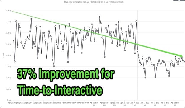

At Splunk, we also have firsthand experience. In early 2020, we worked with a major media customer which had a substantial amount of JavaScript for a variety of third-party domains. By analyzing their site and implementing resource hints such, as preconnect and preload, we improved Time-to-Interactive by 4.9 seconds — that’s 37%.
