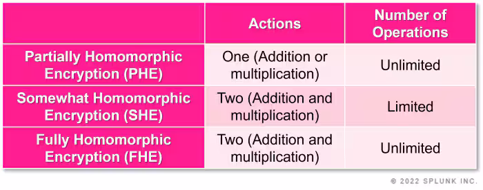

These operations I can perform are addition, multiplication, or both. If you take my flawed example, you’ll see it works with multiplication too. If you’ve heard terms like ‘partially homomorphic’ and ‘fully homomorphic’ encryption, that’s what the difference is - which operations you can perform on the data where the mapping still works.
Types of homomorphic encryption
The fundamental difference between the different types is the frequency of mathematical operations that can be performed on the ciphertext.

The main types of homomorphic encryption are partially homomorphic encryption (PHE), somewhat homomorphic encryption (SHE), and fully homomorphic encryption (FHE), each supporting different levels of computation on encrypted data.
