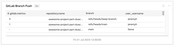

And now you’ve done it! You’ve accepted a generic webhook into your OTEL receiver, parsed the json into a log, sent that log to Splunk, and then turned the log into a metric time series and sent it to Splunk Observability.
What can you do now? Let security know you’ve helped them out with more data. Make a chart of pushes contributing to branches for a major release and see work done over time by your (or other) teams. Create a naughty list of users pushing to main. Throw a pizza party!
Figure 1-1. Who's been naughty and pushed directly to main branch?
But in reality, the real treasure is the things we’ve learned along the way. Right? We’ve learned that webhook JSON data can become log data, how to massage that log data, and even how to turn it into a basic metric. These are advanced capabilities and problem solving tools that may not be immediately apparent but can be life savers. Sometimes a specific set of telemetry data is required but may come from an unexpected or non-native source. But if you can get it in as JSON? You can probably do some amazing things in the OpenTelemetry collector.
