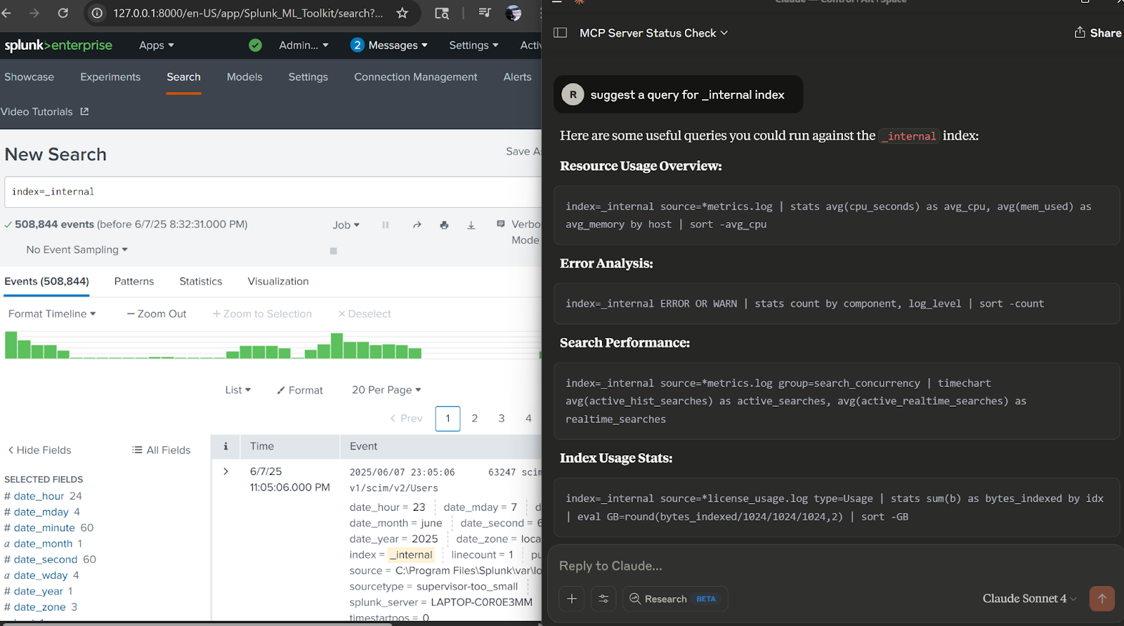

Anthropic has been the primary driver of MCP development and has the most mature support for MCP, but the protocol is designed to be used more broadly across the AI ecosystem. Here is a visual example of how a MCP Server works. In the following screenshot a user asks Claude LLM to create a local file in the specified folder. Claude LLM is hosted in the cloud however via MCP Server it can interact locally with the operator's computer.

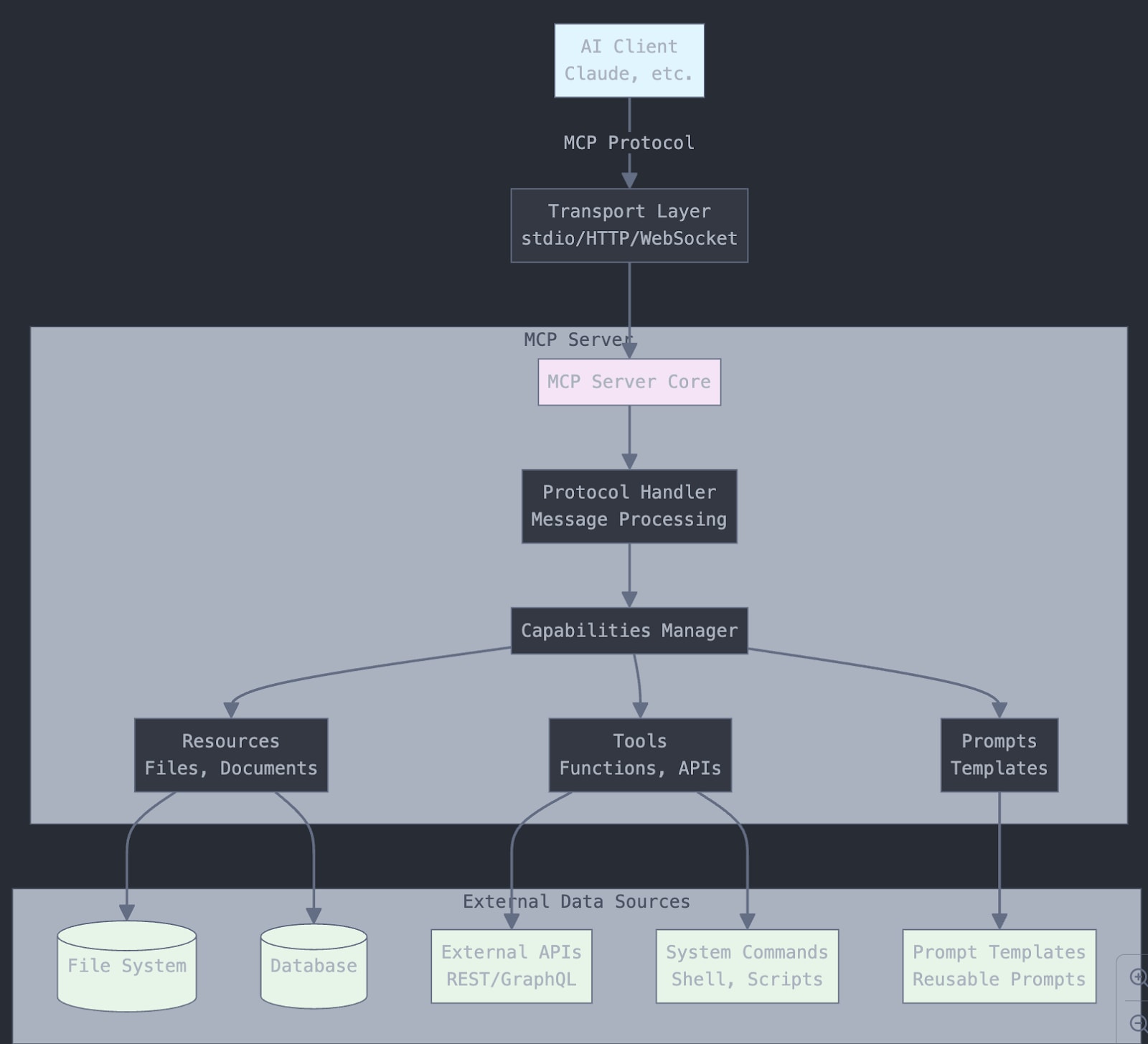

Top Level (Client):
Transport Layer:
MCP Server Core:
External Data Sources:
The server acts as a secure bridge between the AI and your data/tools.

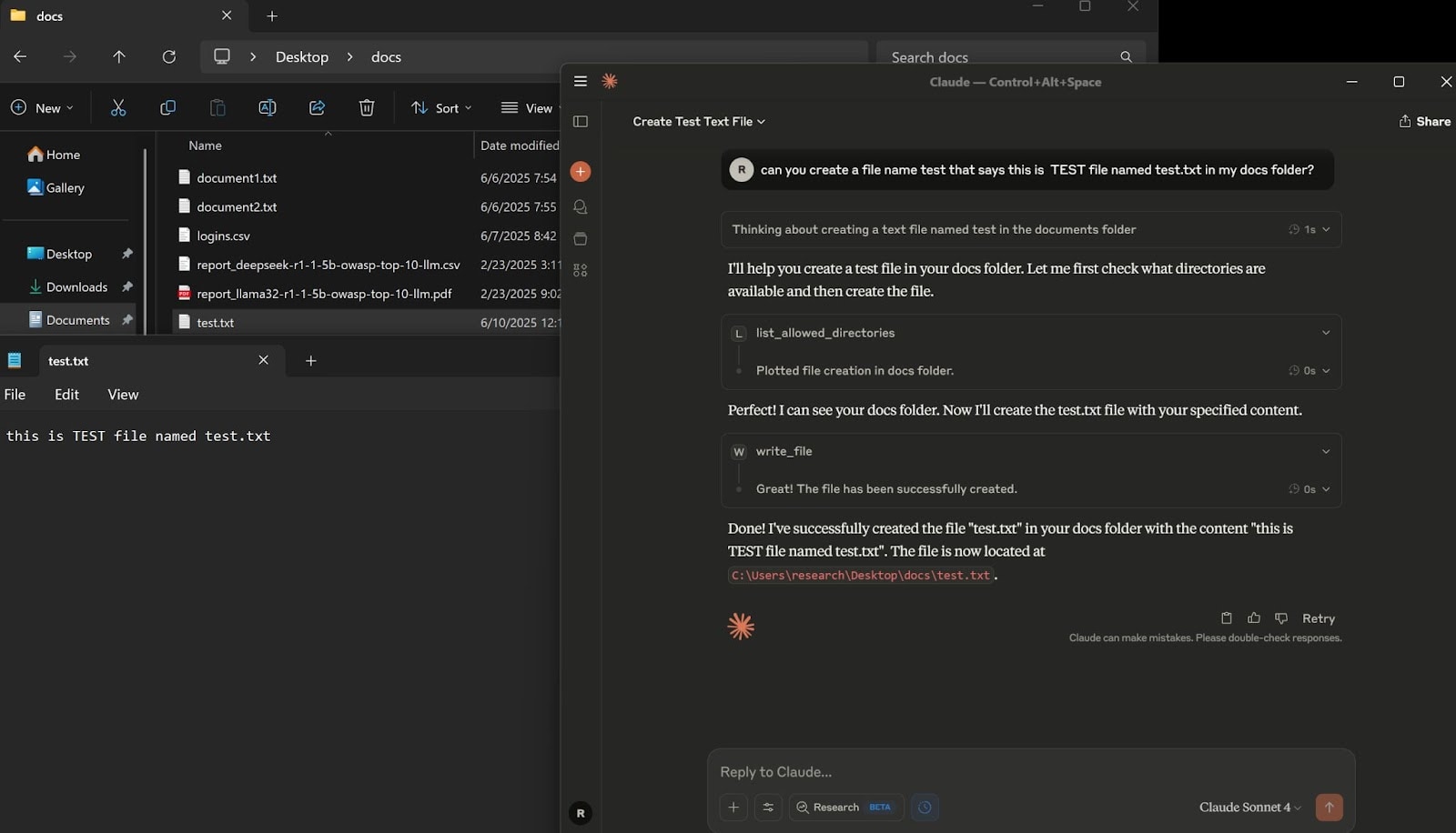

For this research two MCP Servers were created. A MCP file server (interacts with specified folders, can list, read and write files). A Splunk MCP server (interacts with the Splunk instance, including performing SPL queries, reading indexes and even performing application related queries). It is important to note that above actions can be limited by permissions and user’s rights. For example when using MCP file server, Caude desktop will ask you if you allow the action requested at your local system. With Splunk this can be addressed via Splunk accounts and roles permissions. Both of these MCP Servers were installed on a Windows 11 with NVIDIA 4070 GPU and 32 GB of RAM.

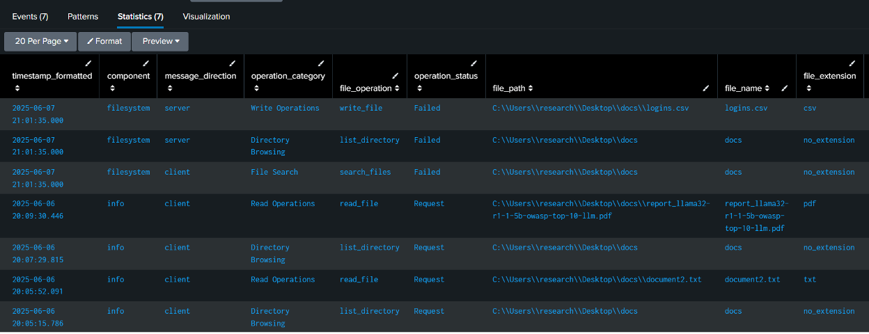

Now that we have an idea on what we have and what to look for let’s take a look at some SPL searches that would give us specific monitoring information on the MCP servers.

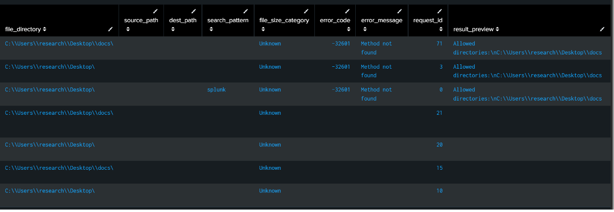

Spl Code - File Operations
index=* (sourcetype=*mcp* OR source=*mcp* OR source=*filesystem*)
("tools/call" OR "read_file" OR "write_file" OR "list_directory" OR "get_file_info" OR "create_directory" OR "move_file" OR "search_files" OR "directory_tree" OR "edit_file")
| rex field=_raw "\"method\":\"tools/call\",\"params\":{\"name\":\"(?P<file_operation>[^\"]+)\",\"arguments\":{(?P<full_arguments>[^}]+)}"
| rex field=full_arguments "\"path\":\"(?P<file_path>[^\"]+)\""
| rex field=full_arguments "\"content\":\"(?P<file_content>[^\"]{0,100})"
| rex field=full_arguments "\"source\":\"(?P<source_path>[^\"]+)\""
| rex field=full_arguments "\"destination\":\"(?P<dest_path>[^\"]+)\""
| rex field=full_arguments "\"pattern\":\"(?P<search_pattern>[^\"]+)\""
| rex field=full_arguments "\"paths\":\[(?P<multiple_paths>[^\]]+)\]"
| rex field=_raw "\"id\":(?P<request_id>[^,}]+)"
| rex field=_raw "\[(?P<component>\w+)\]\s+\[(?P<log_level>\w+)\]"
| rex field=_raw "Message from (?P<message_direction>client|server)"
| rex field=_raw "\"result\":{\"content\":\[{\"type\":\"text\",\"text\":\"(?P<result_preview>[^\"]{0,200})"
| rex field=_raw "\"error\":{\"code\":(?P<error_code>[^,]+),\"message\":\"(?P<error_message>[^\"]+)\""
| where isnotnull(file_operation) AND match(file_operation, "read_file|write_file|list_directory|get_file_info|create_directory|move_file|search_files|directory_tree|edit_file|read_multiple_files")
| eval operation_category=case(
match(file_operation, "read_file|read_multiple_files"), "Read Operations",
match(file_operation, "write_file|edit_file"), "Write Operations",
match(file_operation, "list_directory|directory_tree"), "Directory Browsing",
match(file_operation, "search_files"), "File Search",
match(file_operation, "get_file_info"), "File Information",
match(file_operation, "create_directory"), "Directory Management",
match(file_operation, "move_file"), "File Movement",
true(), "Other Operations"
| eval file_extension=if(isnotnull(file_path) AND match(file_path, "\."),
replace(file_path, ".*\.([^\.\\\\]+)$", "\1"),
if(isnotnull(file_path), "no_extension", "N/A"))
| eval file_directory=if(isnotnull(file_path),
replace(file_path, "^(.*)[\\\\/][^\\\\/]+$", "\1"),
"N/A")
| eval file_name=if(isnotnull(file_path),
replace(file_path, "^.*[\\\\/]([^\\\\/]+)$", "\1"),
"N/A")
| eval operation_status=case(
isnotnull(error_code), "Failed",
isnotnull(result_preview), "Success",
message_direction="server", "Response",
true(), "Request"
| eval file_size_category=case(
match(result_preview, "size:\s*(\d+)") AND tonumber(replace(result_preview, ".*size:\s*(\d+).*", "\1")) > 1000000, "Large (>1MB)",
match(result_preview, "size:\s*(\d+)") AND tonumber(replace(result_preview, ".*size:\s*(\d+).*", "\1")) > 100000, "Medium (100KB-1MB)",
match(result_preview, "size:\s*(\d+)"), "Small (<100KB)",
true(), "Unknown"
| eval timestamp_formatted=strftime(_time, "%Y-%m-%d %H:%M:%S.%3N")
| eval hour_of_day=strftime(_time, "%H")
| eval day_of_week=strftime(_time, "%A")
| sort -_time
| table timestamp_formatted, component, message_direction, operation_category, file_operation, operation_status, file_path, file_name, file_extension, file_directory, source_path, dest_path, search_pattern, file_size_category, error_code, error_message, request_id, result_preview

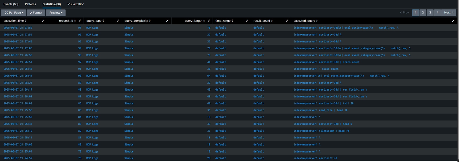

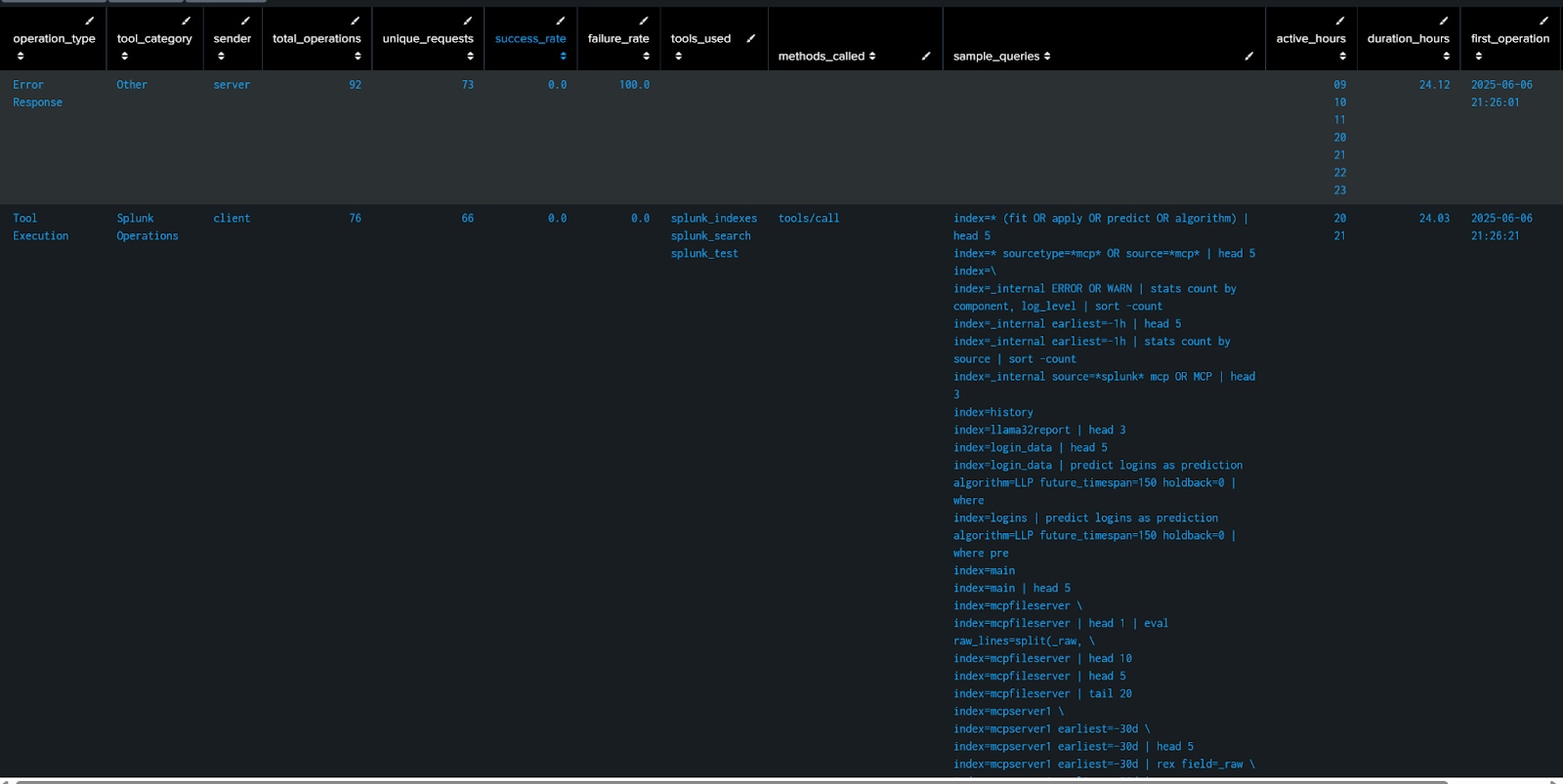

Spl Code - Splunk Queries Performed via MCP Server
index=main sourcetype=mcpjson "tools/call" "splunk_search" | rex field=_raw "\"query\":\"(?P<executed_query>[^\"]+)\"" | rex field=_raw "\"id\":(?P<request_id>[^,}]+)" | rex field=_raw "\"earliest_time\":\"(?P<time_range>[^\"]+)\"" | rex field=_raw "\"count\":(?P<result_count>[^,}]+)" | where isnotnull(executed_query) | eval query_type=case( match(executed_query, "(?i)index=\\*"), "Cross-Index Search", match(executed_query, "(?i)index=_internal"), "Internal Logs", match(executed_query, "(?i)index=main"), "Main Index", match(executed_query, "(?i)index=mcp"), "MCP Logs", match(executed_query, "(?i)\\| rest"), "REST API Call", match(executed_query, "(?i)\\| makeresults"), "Data Generation", match(executed_query, "(?i)\\| inputlookup"), "Lookup Table", match(executed_query, "(?i)predict"), "Machine Learning", match(executed_query, "(?i)stats|eval|where"), "Data Analysis", true(), "Other" ) | eval query_complexity=case( len(executed_query) > 200, "Complex", len(executed_query) > 100, "Medium", true(), "Simple" ) | eval execution_time=strftime(_time, "%Y-%m-%d %H:%M:%S") | eval query_length=len(executed_query) | eval time_range=coalesce(time_range, "default") | eval result_count=coalesce(result_count, "default") | table execution_time, request_id, query_type, query_complexity, query_length, time_range, result_count, executed_query | sort -_time

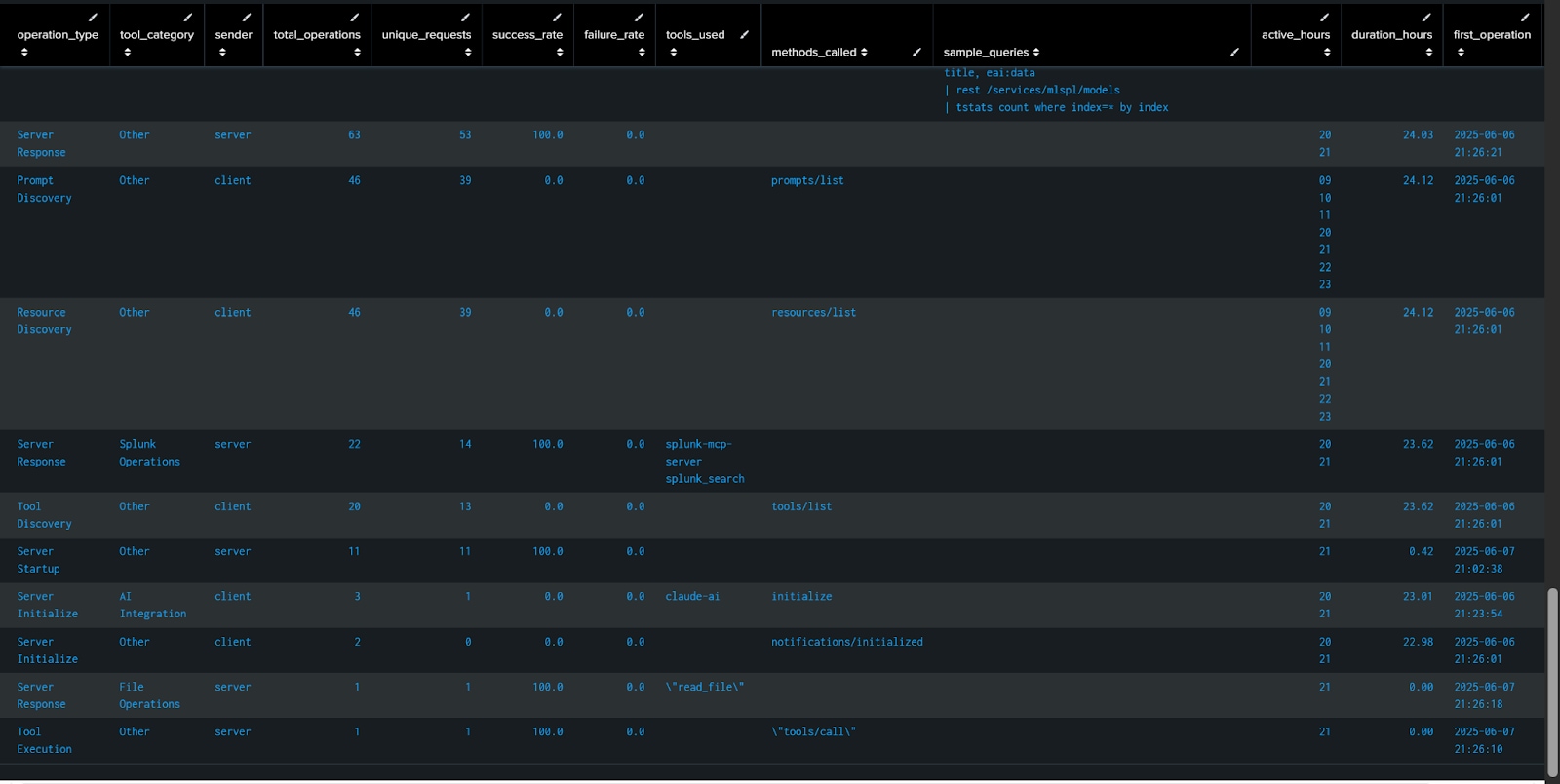

Spl Code - MCP Server Operations
| rex field=_raw "\"method\":\"(?P<method>[^\"]+)\""
| rex field=_raw "\"name\":\"(?P<tool_name>[^\"]+)\""
| rex field=_raw "Message from (?P<sender>server|client)"
| rex field=_raw "\"error\":\{\"code\":(?P<error_code>[^,]+)"
| rex field=_raw "\"query\":\"(?P<splunk_query>[^\"]{1,100})"
| eval operation_type=case(
match(method, "tools/call"), "Tool Execution",
match(method, "tools/list"), "Tool Discovery",
match(method, "initialize"), "Server Initialize",
match(method, "notifications/initialized"), "Initialization Complete",
match(method, "prompts/list"), "Prompt Discovery",
match(method, "resources/list"), "Resource Discovery",
match(_raw, "Initializing"), "Server Startup",
isnotnull(error_code), "Error Response",
sender="server" AND isnull(method), "Server Response",
sender="client" AND isnull(method), "Client Request",
true(), "Unknown"
| eval tool_category=case(
match(tool_name, "splunk"), "Splunk Operations",
match(tool_name, "read_file|write_file|list"), "File Operations",
match(tool_name, "claude"), "AI Integration",
true(), "Other"
| eval success_status=case(
match(_raw, "\"result\""), "Success",
true(), "Pending"
| stats
count as total_operations,
dc(request_id) as unique_requests,
values(tool_name) as tools_used,
values(method) as methods_called,
count(eval(success_status="Success")) as successful_ops,
count(eval(success_status="Failed")) as failed_ops,
values(error_code) as error_codes,
values(splunk_query) as sample_queries,
earliest(_time) as first_operation,
latest(_time) as last_operation,
values(hour_of_day) as active_hours,
values(day_of_week) as active_days
by operation_type, tool_category, sender
| eval
success_rate=round((successful_ops/total_operations)*100, 1),
failure_rate=round((failed_ops/total_operations)*100, 1),
duration_hours=round((last_operation-first_operation)/3600, 2),
first_operation=strftime(first_operation, "%Y-%m-%d %H:%M:%S"),
last_operation=strftime(last_operation, "%Y-%m-%d %H:%M:%S")
| table operation_type, tool_category, sender, total_operations, unique_requests, success_rate, failure_rate, tools_used, methods_called, sample_queries, active_hours, duration_hours, first_operation, last_operation
| sort -total_operations
