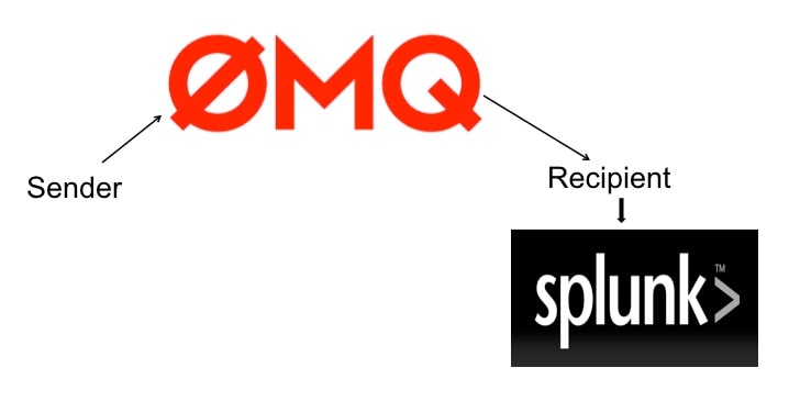

I looked around and turned to Zeromq (or known as 0MQ). It is open source, does not rely on a persistent store making it light weight and performance rich, and has a variety of client language bindings, although the core implementation is in C/C++. Zeromq also implements a variety of messaging design patterns making it flexible to adapt to your needs. Essentially, I built a few scripted inputs that call a zeromq listener to receive messages. These messages are then sent to standard output so they can be indexed into Splunk for further search and analysis. In my reference implementation, I wrote senders that send random time series temperature data messages as it’s easy to understand and Splunk’s reporting features can provide nice real-time graphs for such input. The approach can be summarized in this rather simple diagram.
