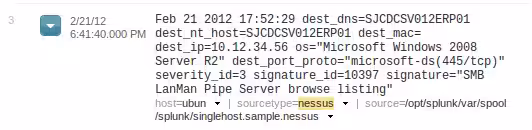

Let’s head into more modern times and look at what Splunk can do with very little effort against sample vulnerability scan data. I’ve used Nessus as the scanner in the examples, but the same principals should apply to your own favorite scanner. A sample event may look like this:
Nessus Event
It is mostly unstructured, but some of the fields will be extracted automatically by Splunk at search time as they are in key=value format. My first report may be similar to the one I described above where I want to find a count of all signatures (vulnerabilities are now called signatures) found. The Splunk search could be:

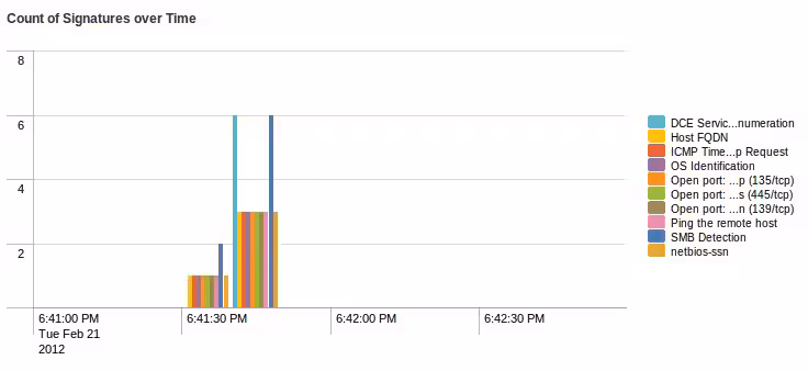

Now, let’s try something a little more graphical where I would like to see a graph of these same signatures over time using a column graph. In the old days, TCL would not have been able to do this and I would have had to spent some time learning and using the accompanying TK language for the chart. In Splunk the search is as follows using a custom time range:
sourcetype=nessus|timechart count by signature span=30s
Timechart Vulnerabilites
