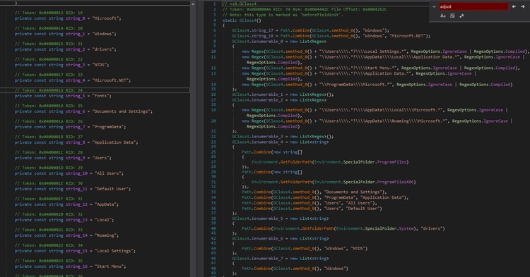

This malware is a .net compiled binary that has a customized obfuscation and a large amount of junk code that makes analysis harder to accomplish. Before performing its destructive functions it will list several directory names and paths where it will look for files it will wipe.

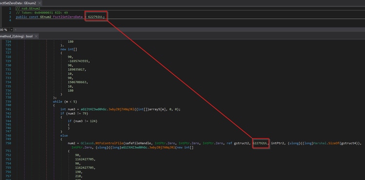

Then It will open the target file using NtOpenFile() native API to zero or wipe it using a native API NtFsControlFile() that sends an IOCTL control code FSCTL_SET_ZERO_DATA directly to a specified file system. The wiper can wipe system files that make the compromised host unbootable after the restart. Below is the code screenshot of how this API was used in this wiper to do its destructive function.

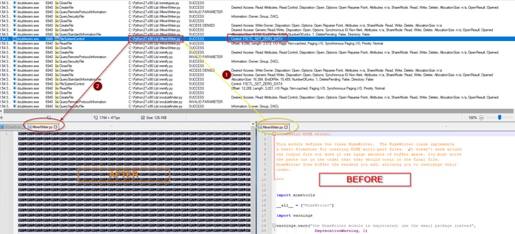

Below is an example of the event that happened to the compromised test lab while it wipes the file. We can see how the “MimeWriter.py” file was wiped with zero bytes after calling the IOCTL code FSCTL_SET_ZERO_DATA.

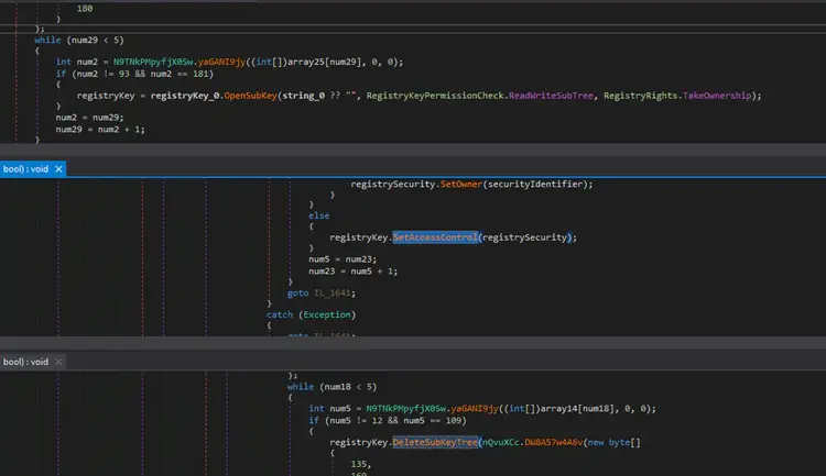

Then it will change the ownership of the registry to the current logo user and change the access control to full access to delete each of the subkeys in each HKLM, HKCU, HKU registry hive. Below is the code snippet spread out in one of its classes that modifies the owner and access control to the registry to delete all of its registry subkeys.
