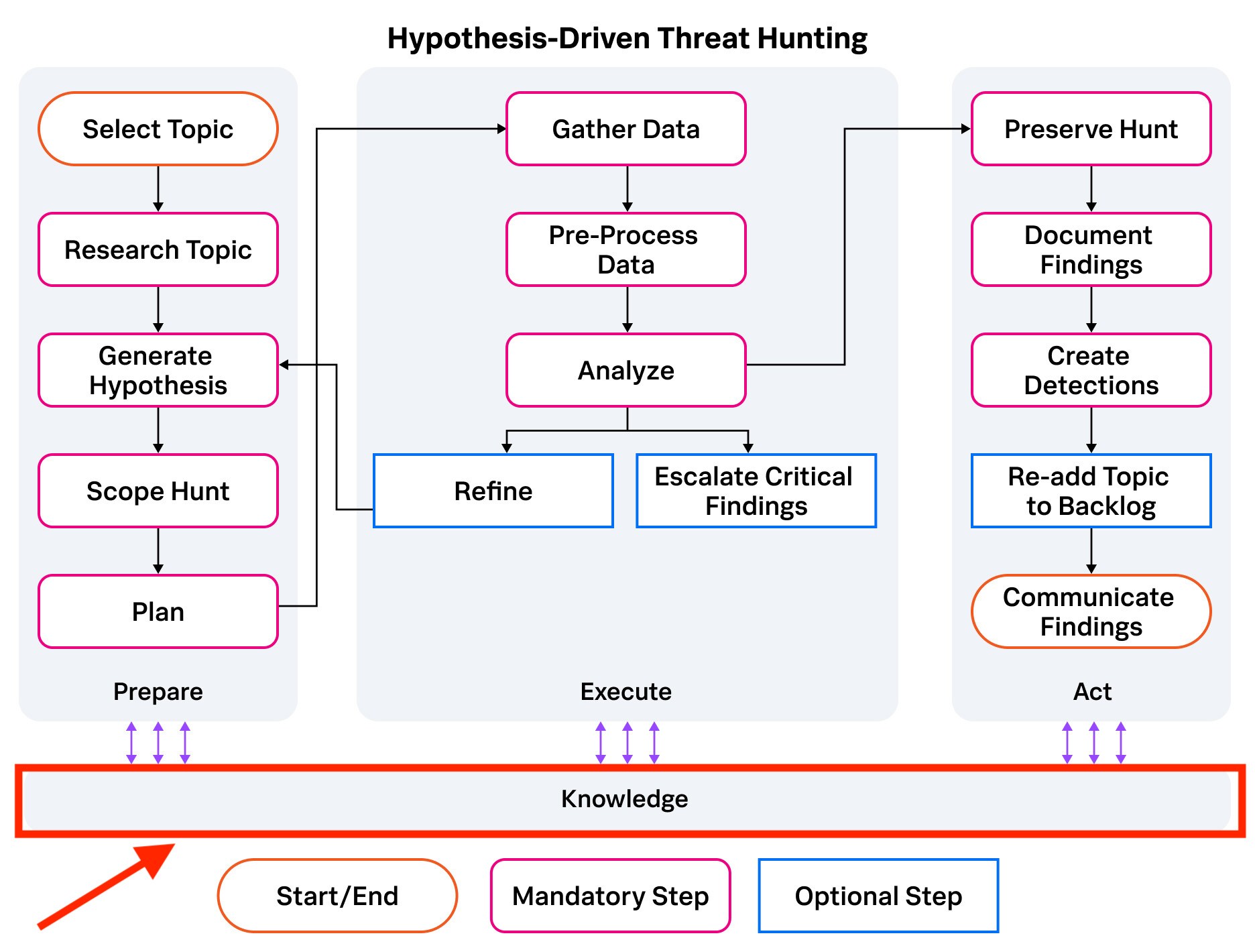

The PEAK Threat Hunting Framework incorporates three distinct hunt types: hypothesis-driven, baseline and model-assisted threat hunts. Each hunt type follows a three-stage process: Prepare, Execute, and Act. Each phase of a hunt also integrates Knowledge, which together make up the PEAK acronym (Prepare, Execute, and Act with Knowledge).
Through all your preparing, executing and acting, you are learning about your environment and a specific threat. With all this work being put in, you have new insight that needs to be shared. This is where the “Knowledge” aspect of the PEAK Threat Hunting Framework really shines and where you can reap the most benefits with threat hunting. You take that insight and build new detections, find data gaps, or even new hunt ideas.

Hypothesis-Driven Hunting Process in the PEAK Framework

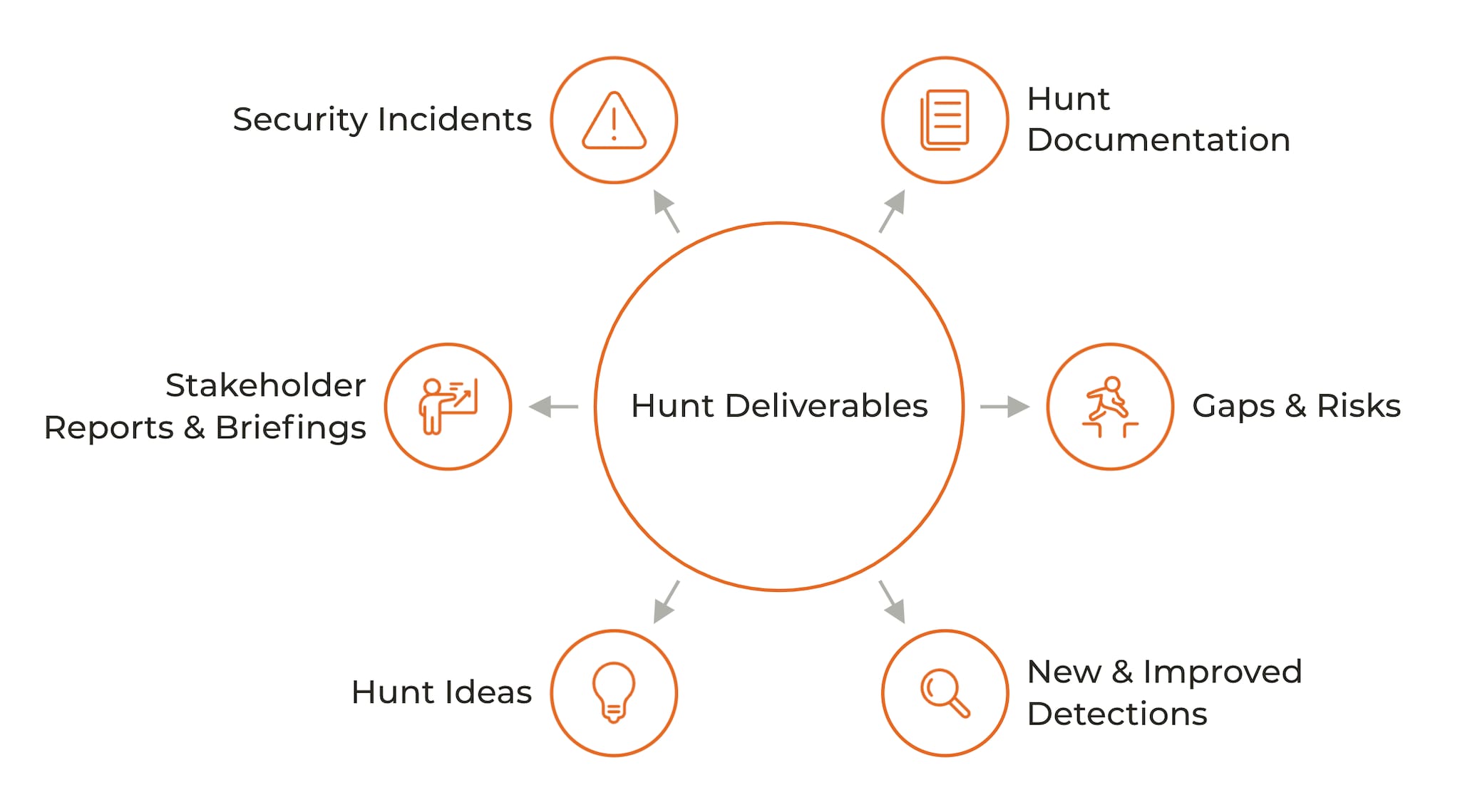

Deliverables
Taking your hunting knowledge and creating key deliverables is where you, as a hunter, can show the impact of your work. Each threat hunt you perform can have the deliverables listed below as options for outputs. These are key to measuring your hunting success and ensuring you are maturing your hunt program.

While there are many options for deliverables of hunts, not all outputs will apply for each hunt. Each hunt is unique and will look different. Don't let this list limit you! Hunt outputs can take all types of forms.
