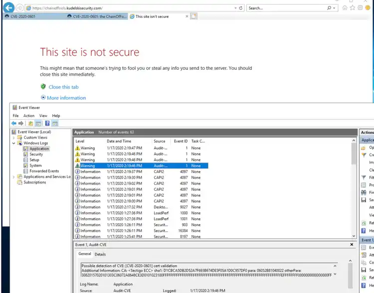

I promised you I’d give you a couple of options, in case you’re not using Zeek yet. On the same VM, I installed the patch, then restarted the system. Once again, I browsed to the fake website, but this time the certificate wasn’t valid.

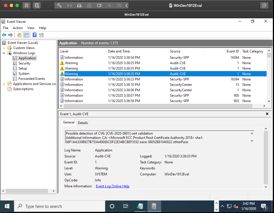

Microsoft added an API call in Windows 10 and Server 2016 (or higher) to log an entry in the Application log when an exploit attempt is made against a vulnerability that has been patched. Presumably due to the criticality of this vulnerability, Microsoft made this API call in their patch for CVE-2020-0601.
Volumes have been written, and many hours of .conf talks have been dedicated to Splunking the Endpoint, specifically around Microsoft Sysmon. If you haven’t gotten there yet, (and you really should make the time, but first finish patching!) that’s ok, you don’t need Sysmon for this detection. You will, however, need the Application log from the Windows Event log. Usually we are looking at the Security log, but not today.
sourcetype="XmlWinEventLog" eventtype=”wineventlog_application” EventCode=1 Name="'Microsoft-Windows-Audit-CVE'"
| table _time dest CVEID
To find these events, the key fields to search for are: Name=“Microsoft-Windows-Audit-CVE” and EventCode=“1”. I love this event… what better detection mechanism than the vendor providing the patch for the vulnerability shouting “Hey! Look! Over here, something bad is happening!”
