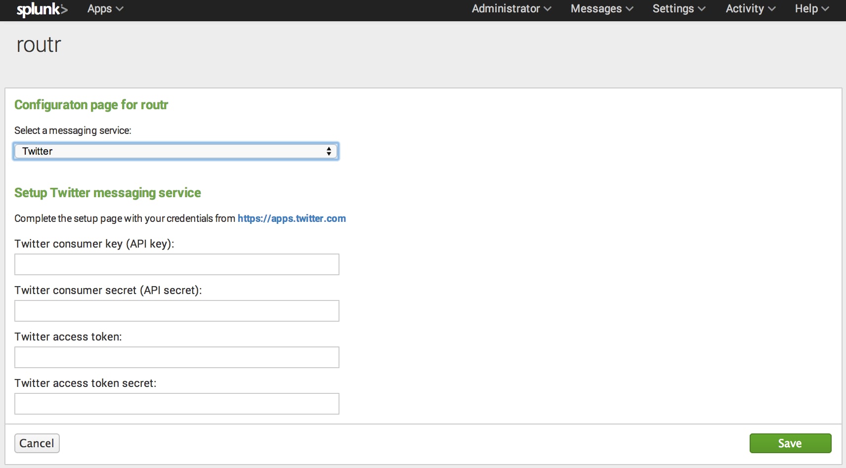

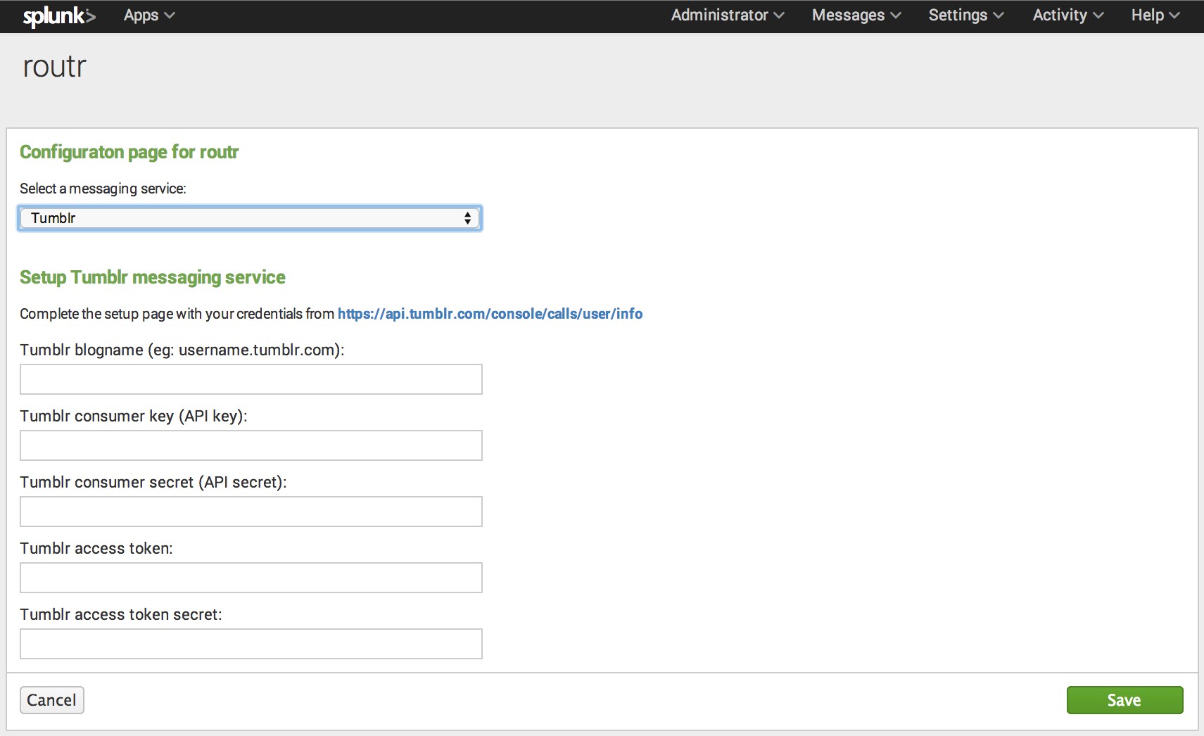

  2. Go to the following Splunk app endpoint /manager/routr/apps/local/routr/setup?action=edit
  3. Update the setup form with the appropriate oauth and access token credentials and click Save button

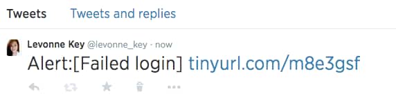

  6. If you have configured your Twitter credentials, go to your Twitter account page and you should see a tweet within 1 minute.                                                                             Screen Shot 2014-07-21 at 6.10.09 PM

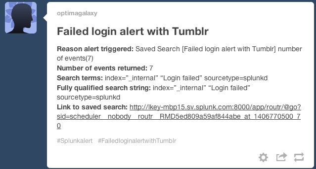

  7. If you have configured your Tumblr credentials, go to your Tumblr page and you should see a Tumblr post within 1 minute.
        Screen Shot 2014-07-30 at 6.35.28 PM
