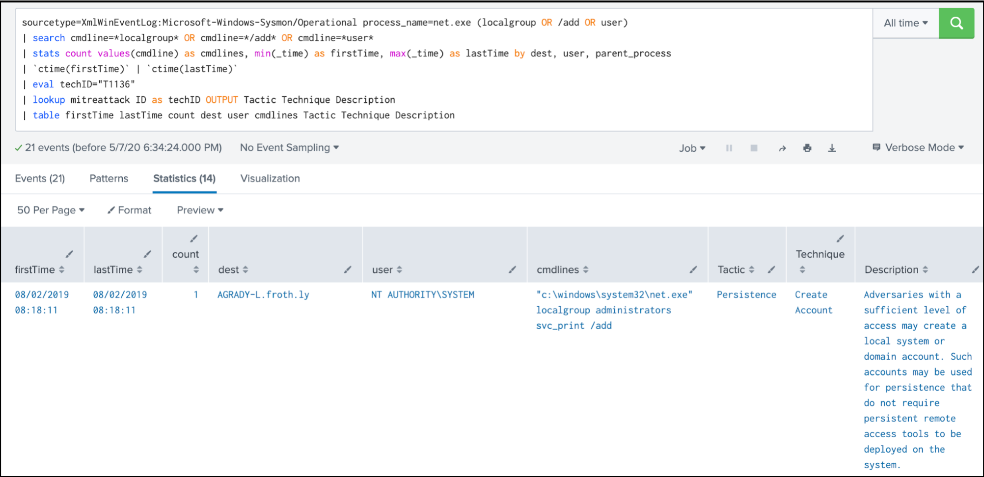

Here is a correlation search with MITRE ATT&CK mapped to it and its results:
sourcetype=XmlWinEventLog:Microsoft-Windows-Sysmon/Operational process_name=net.exe (localgroup OR /add OR user)
| search cmdline=*localgroup* OR cmdline=*/add* OR cmdline=*user*
| stats count values(cmdline) as cmdlines, min(_time) as firstTime, max(_time) as lastTime by dest, user, parent_process
| `ctime(firstTime)` | `ctime(lastTime)`
| eval techID="T1136"
| lookup mitreattack ID as techID OUTPUT Tactic Technique Description
| table firstTime lastTime count dest user cmdlines Tactic Technique Description
The first part of the analytic can be an SPL structured or unstructured search or it could be a tstats search using accelerated data models. But when we get to the section in bold above, this is where MITRE ATT&CK mapping comes into play. The eval command is used to define the technique associated with the analytic by using the MITRE ATT&CK identifier, in this case T1136, and then we can use the lookup command to get the tactic, technique, and description from the mitreattack reference table that I loaded onto my system. There are additional values from ATT&CK that could be added as well but you get the idea. Finally, using the table command, we specify the fields that we want written to the notable index since we are creating a notable event with this correlation search.
