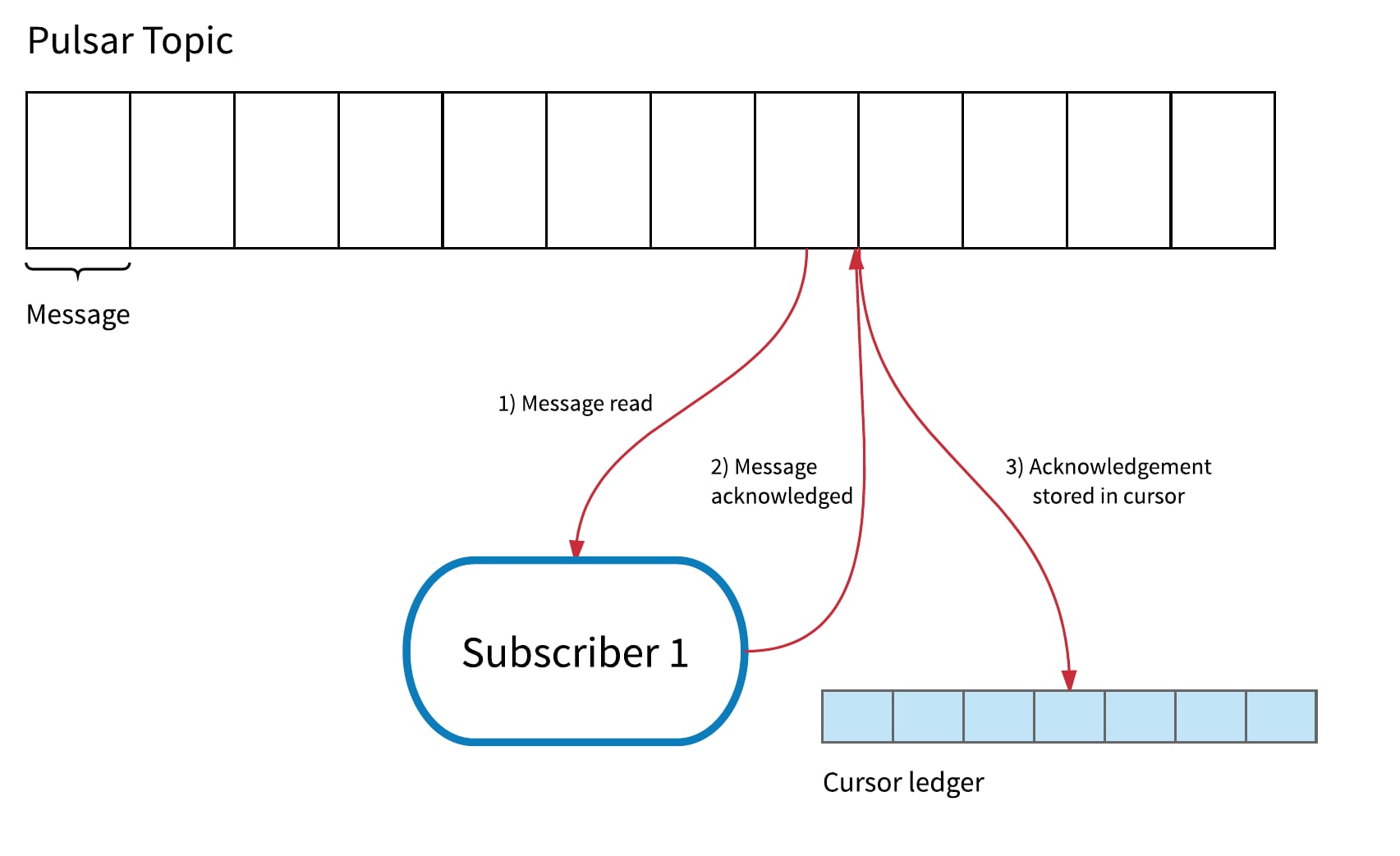

Figure 1. A basic illustration of cursors in Pulsar

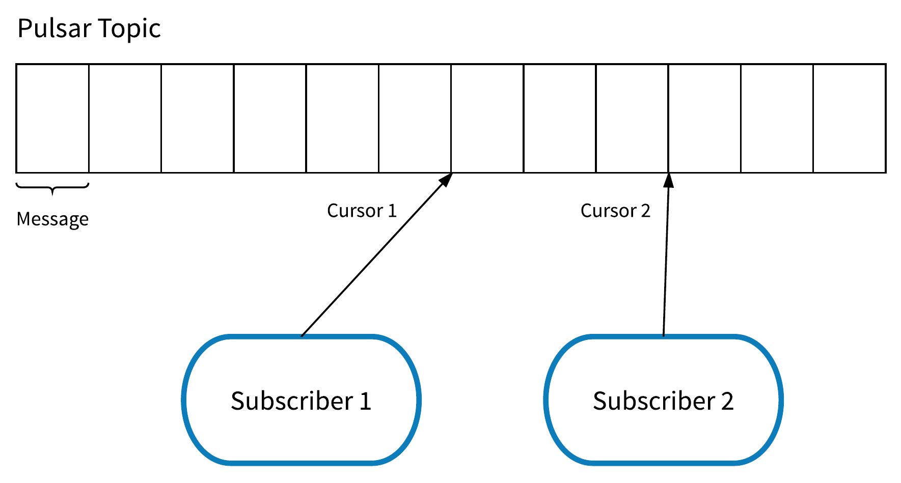

In Pulsar, each subscription for a topic has a cursor. This cursor is updated any time the subscriber acks a message on the topic. Updating the cursor ensures that the subscriber will not receive that message again — even when the subscriber crashes, recovers, and reattaches to the subscription.

How Pulsar uses BookKeeper to store cursors is quite simple. The broker maintains a BookKeeper ledger for each subscriber, called the cursor ledger. A ledger can be thought of as an append-only replicated log.
When a subscriber has read a message and processed it, it sends an acknowledgement message to the broker. The broker then writes an update into the cursor ledger for that subscription. If the broker then fails, it recovers the cursor for the subscription by reading the last entry of the cursor ledger from BookKeeper.
Figure 2. Multiple subscribers on a topic
