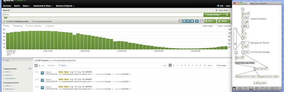

Here I’m testing a simple Max/MSP patch using the [udpsend] object to Splunk listening on localhost:8002.
Using Splunk to check consistency of a sin function based log generator written in Max.
The Max patch to the right is generating a log entry many times a second, the exact amount being modulated by a [sin] object. Since the sin wave is pretty easy to detect discrepancies in, I can just eyeball for dropped packets or latency. With this information, and an eye on my system load using some code stolen from our Unix App, I can safely proceed knowing what load I can push my system to during demos running both Splunk and Max before I see problems using this setup.
