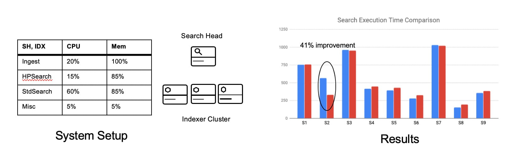

The example below illustrates the impact of workload management on high priority searches. The system consists of 3 indexers and a search head with the resource allocation as shown below. The HPSearch pool is configured with 15% CPU allocation in this example, but generally, you will give more resources to this pool (even as high as 70-80%). If unused, the CPU cycles will be shared with workloads allocated to other pools.
The results show the execution time (seconds) for searches, S1 to S9. The blue graph shows the execution time without workload management enabled. The red graph shows the execution time with workload management enabled, and S2 placed in the HPSearch pool while all other searches placed in the StdSearch pool. The comparison shows ~41% reduction in search execution time for S2 when placed in the HPSearch pool. There was a minor increase in search execution time of other searches. It is important to understand that Workload Management does not increase your overall system resources. It allocates resources to higher priority workload as defined by the admin.
