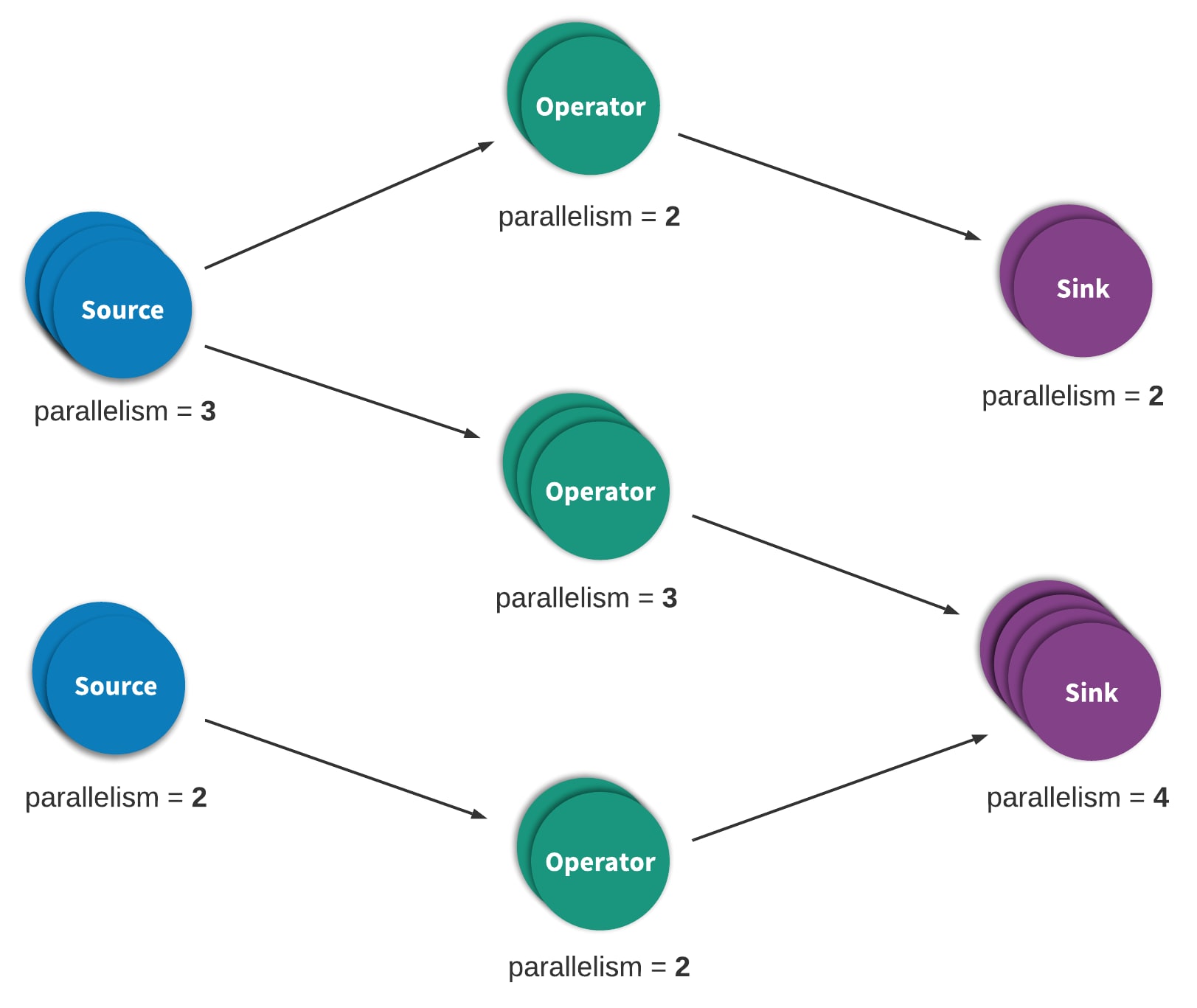

Stream processing, sometimes referred to as event processing, can be succinctly described as continuous processing of an unbounded series of data or events. A stream- or event-processing application can be more or less described as a directed graph and often, but not always, as a directed acyclic graph (DAG). In such a graph, each edge represents a flow of data or events and each vertex represents an operator that uses application-defined logic to process data or events from adjacent edges. There are two special types of vertices, commonly referenced as sources and sinks. Sources consume external data/events and inject them into the application while sinks typically gather results produced by the application. Figure 1 below depicts an example a streaming application.
Figure 1. A typical Heron processing topology

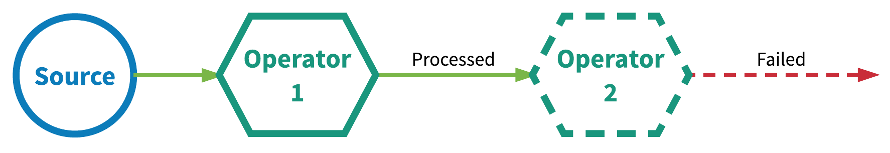

This is essentially a "best effort" approach. Data or events are guaranteed to be processed at most once by all operators in the application. This means that no additional attempts will be made to retry or retransmit events if it was lost before the streaming application can fully process it. Figure 2 illustrates an example of this.
Figure 2. At-most-once processing semantics

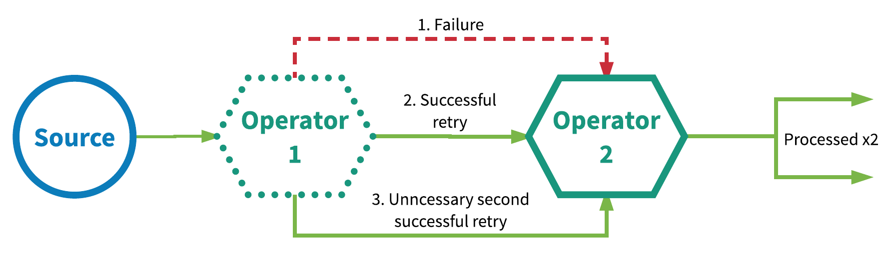

Data or events are guaranteed to be processed at least once by all operators in the application graph. This usually means an event will be replayed or retransmitted from the source if the event is lost before the streaming application fully processed it. Since it can be retransmitted, however, an event can sometimes be processed more than once, thus the at-least-once term. Figure 3 illustrates an example of this. In this case, the first operator initially fails to process an event, then succeeds upon retry, then succeeds upon a second retry that turns out to have been unnecessary.
Figure 3. At-least-once processing semantics

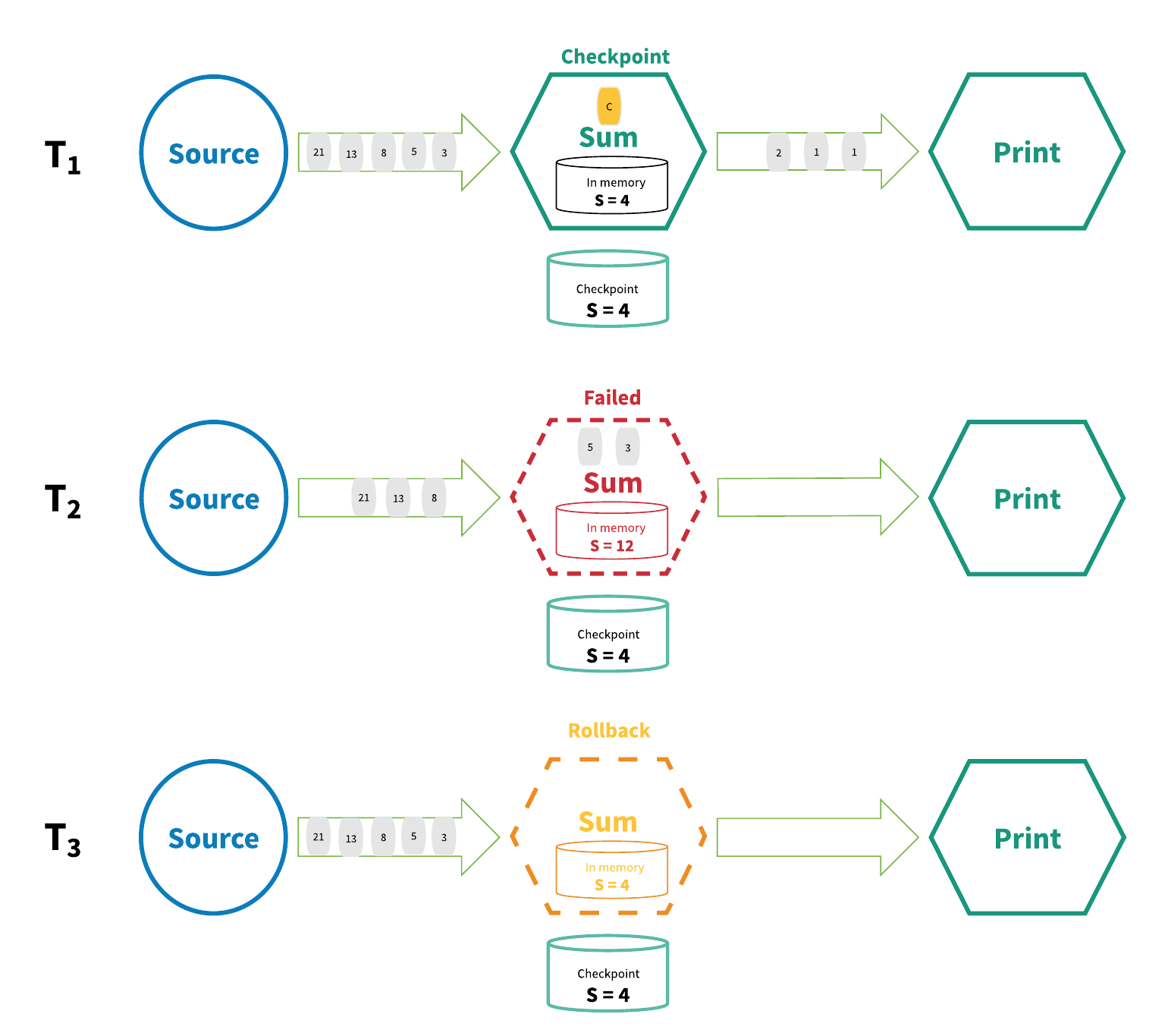

The distributed snapshot/state checkpointing method of achieving "exactly-once" is inspired by the Chandy-Lamport distributed snapshot algorithm.1 With this mechanism, all the state for each operator in the streaming application is periodically checkpointed, and in the event of a failure anywhere in the system, all the state of for every operator is rolled back to the most recent globally consistent checkpoint. During the rollback, all processing will be paused. Sources are also reset to the correct offset corresponding to the most recent checkpoint. The whole streaming application is basically rewound to its most recent consistent state and processing can then restart from that state. Figure 4 below illustrates the basics of this mechanism.
Figure 4. Distributed snapshot
In Figure 4, the streaming application is working normally at T1 and the state is checkpointed. At time T2, however, the operator fails to process an incoming datum. At this point, the state value of S = 4 has been saved to durable storage, while the state value S = 12 is held in the operator’s memory. In order to overcome this discrepancy, at time T3 the processing graph rewinds the state to S = 4 and "replays" each successive state in the stream up to the most recent, processing each datum. The end result is that some data have been processed multiple times, but that’s okay because the resulting state is the same no matter how many rollbacks have been performed.

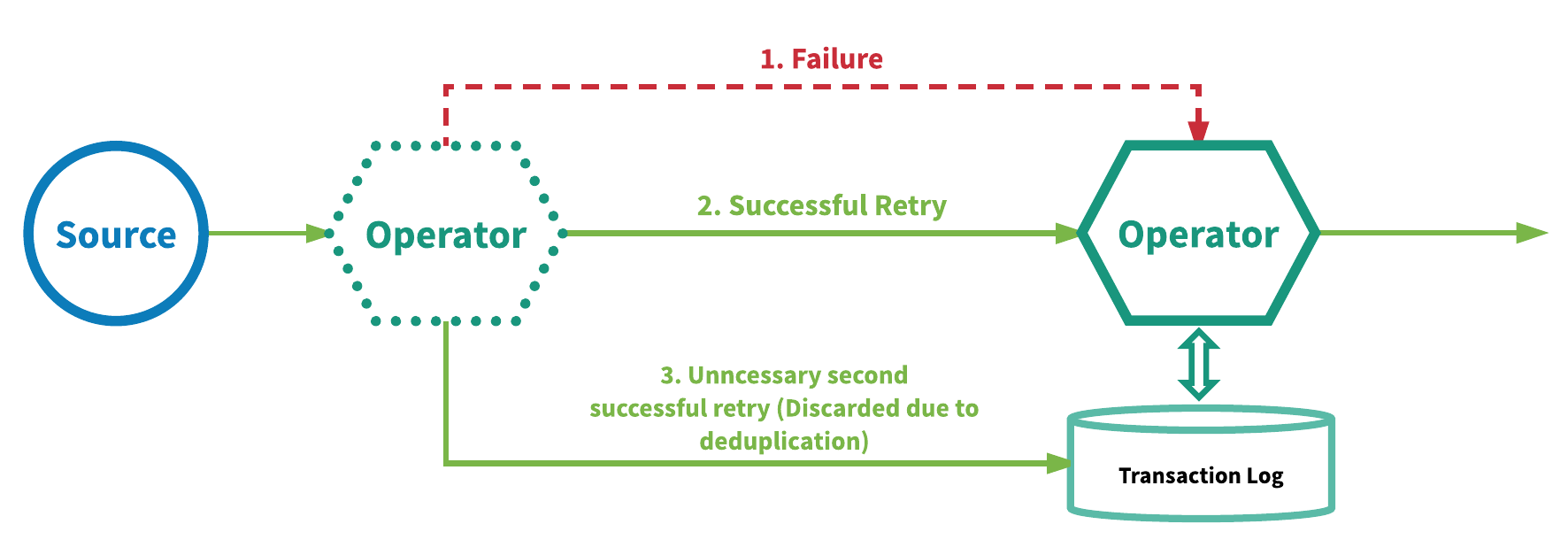

Another method used to achieve "exactly-once" is through implementing at-least-once event delivery in conjunction with event deduplication on a per-operator basis. SPEs utilizing this approach will replay failed events for further attempts at processing and remove duplicated events for every operator prior to the events entering the user defined logic in the operator. This mechanism requires that a transaction log be maintained for every operator to track which events it has already processed. SPEs that utilize a mechanism like such are Google’s MillWheel2 and Apache Kafka Streams. Figure 5 illustrates the gist of this mechanism.
Figure 5. At-least-once delivery plus deduplication
