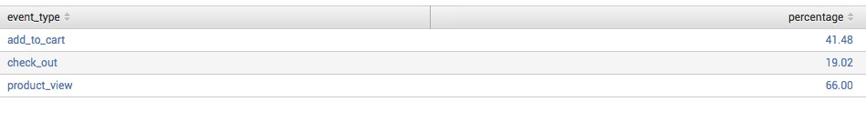

My brilliant colleague Gilberto Castillo noted that there is a much more efficient way to do this, as long as your data allows you to define each step in your funnel based on a single field like “event_type” (If you wanna get really fancy, you could create a single field by using the eval function to concatenate the multiple fields into one field.)
His approach bypasses the use of the appendcols function entirely and just counts unique visitors by event_type.
sourcetype="funnel" event_type="*"
| rex "(?<VisitorID>[0-9a-zA-Z]+)\s+event"
| eventstats dc(VisitorID) AS all_visitors
| search (event_type="product_view" OR event_type="add_to_cart" OR event_type="check_out")
| stats values(all_visitors) AS all_visitors dc(VisitorID) AS dc_event_type by event_type
| eval percentage=round(dc_event_type/all_visitors*100,2)
| fields - all_visitors dc_event_type
funnel_6
