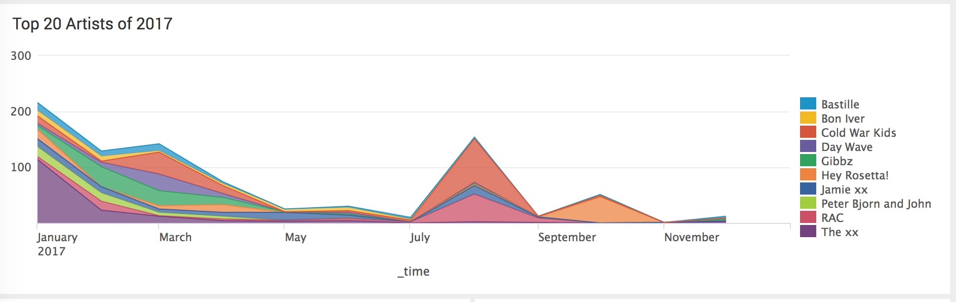

Now it's time to get ambitious. What are my top 20 artists of 2017 based on listens?
`lastfm` | timechart count(artist) by artist useother=f usenull=f| sort -count(artist) limit=20
By stacking my area chart, I can also see at-a-glance that my overall listens of these top 20 artists increased over time as well.

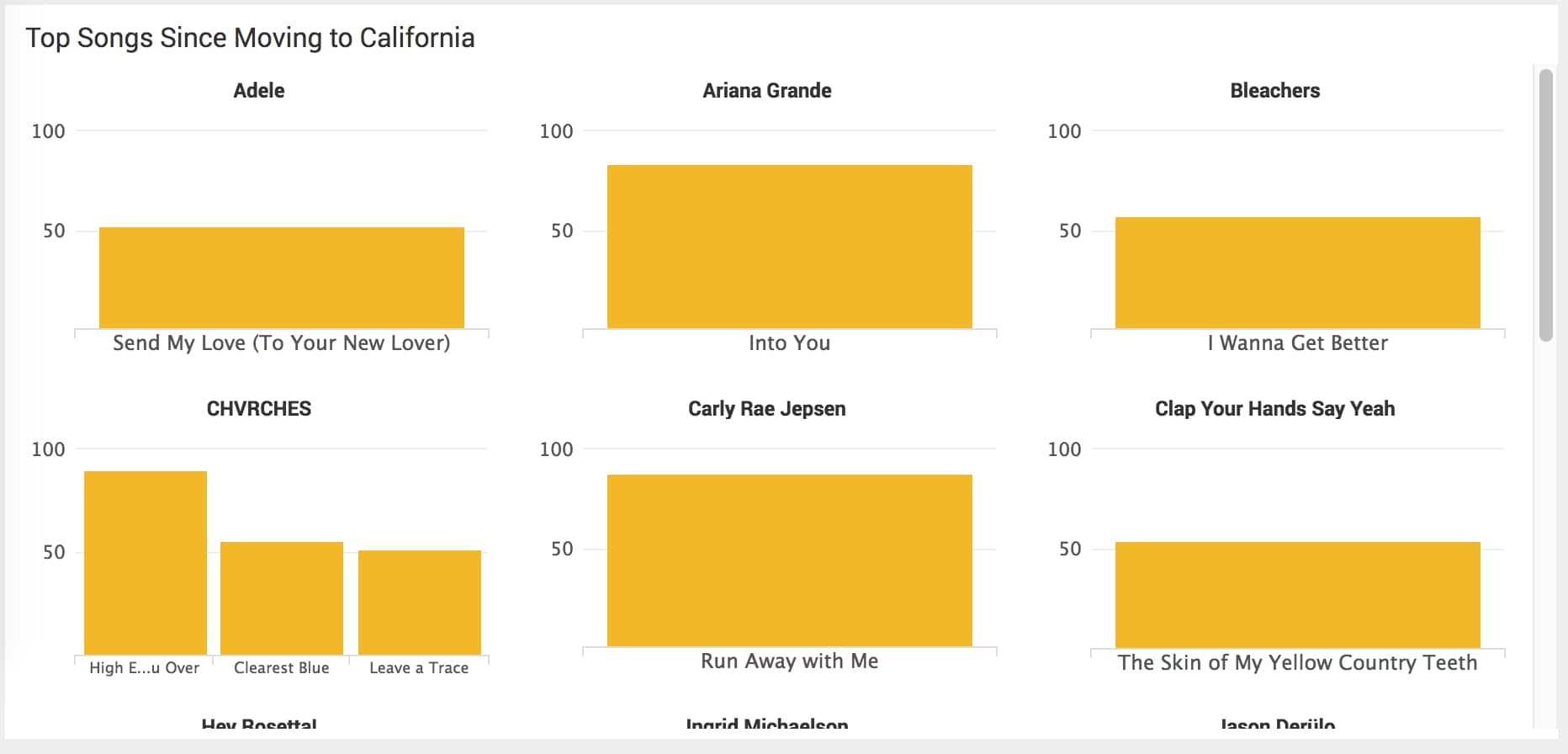

I'm feeling accomplished already, but I want to set up another search to show me the top 20 songs I've listened to after moving to California. Sort of my "California era" of music listening.
index=music | stats count(track_name) by track_name,artist | sort -count(track_name) limit=20
However, I'd originally chosen to display that information in a bar chart...and it was ugly. You could barely read it, it didn't communicate information clearly, and it didn't even have room to list the artists or track names I was listening to. It was time for a new visualization. Enter: trellis.
A simple flip to a column chart with a trellis layout split by artist, and I was almost there. It defaulted to a shared scale that chopped off the y-axis, so I specified a minimum y-axis value of 0 and I'm back in action.

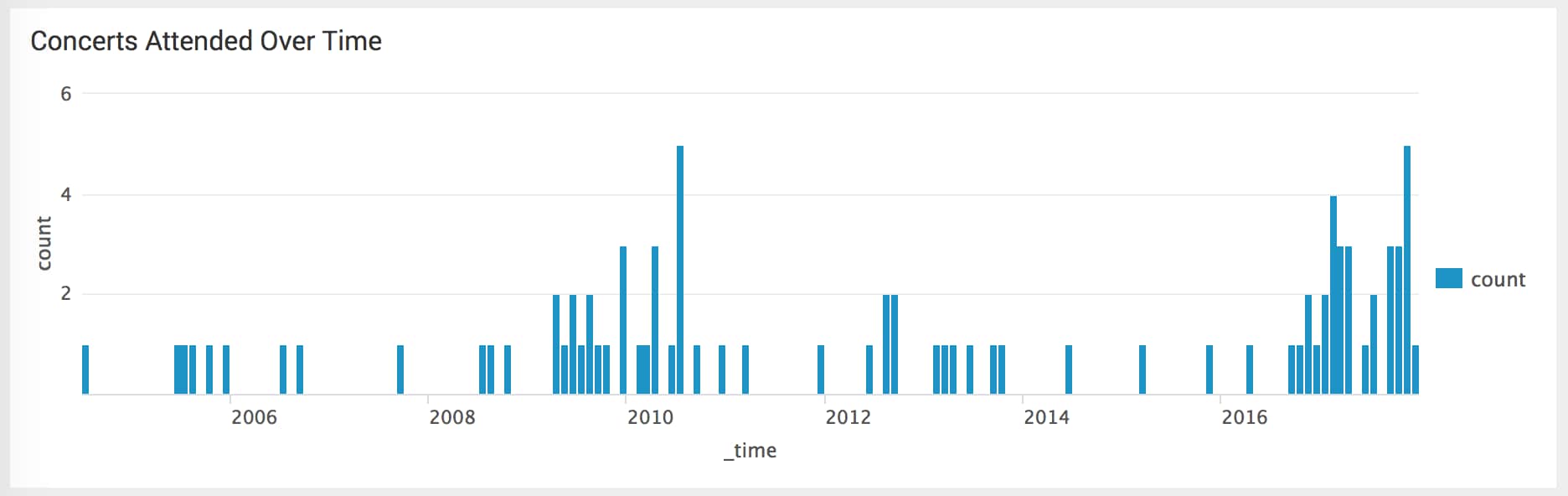

I want to keep going and start looking at another data source: concert data. I have this lookup of concert data and I want to analyze it across time. However, because this is a lookup, I can't just write this search:
| inputlookup concerthistoryparse.csv | timechart span=1mon count
Sure, I have a date field in there, but timechart doesn't know it's a time field, nor does it know what format it's in. Because timechart requires a _time field to perform statistical analysis over time, I have to convert the date field from the lookup into the _time field. Luckily, I can use the convert search command to do just that.
| inputlookup concerts.csv | convert timeformat="%B %d %Y" mktime(date) AS _time | timechart span=1mon count
If I specify the format of the time using strftime then I can convert my date field from the lookup in to a _time field that timechart recognizes.

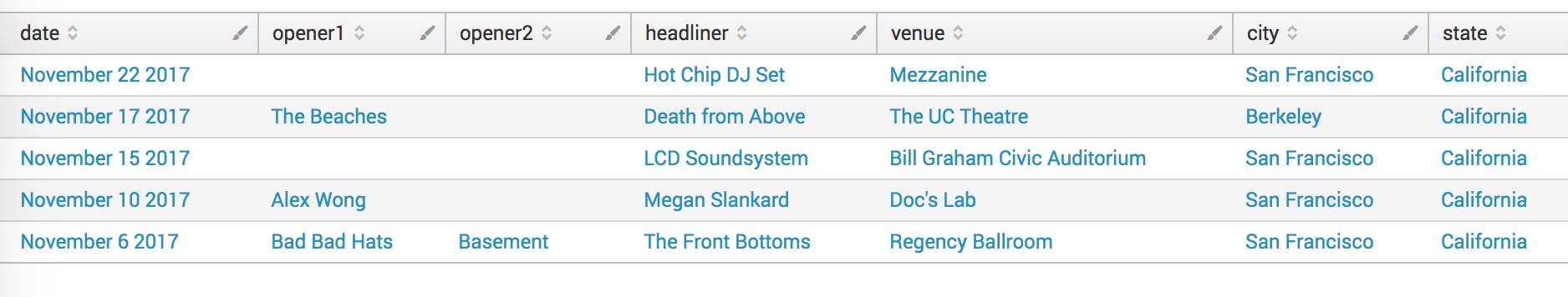

But wait, I want a drill down in this panel too. I want it to show me exactly which five concerts I attended in the month I clicked in the chart.
<drilldown> <set token="clicktime">$click.value$</set> <link target="_blank">search?q=| inputlookup concerthistoryparse.csv | convert timeformat="%B %d %Y" mktime(date) AS _time | eval month = strftime(_time,"%m"), year = strftime(_time,"%Y"), clickmonth = strftime($clicktime$,"%m"), clickyear = strftime($clicktime$,"%Y") | where month=clickmonth and year=clickyear | table date, opener1,opener2, headliner, venue, city, state</link> </drilldown>
I had a really eventful November, so let's open the drilldown for that month and see what we get.

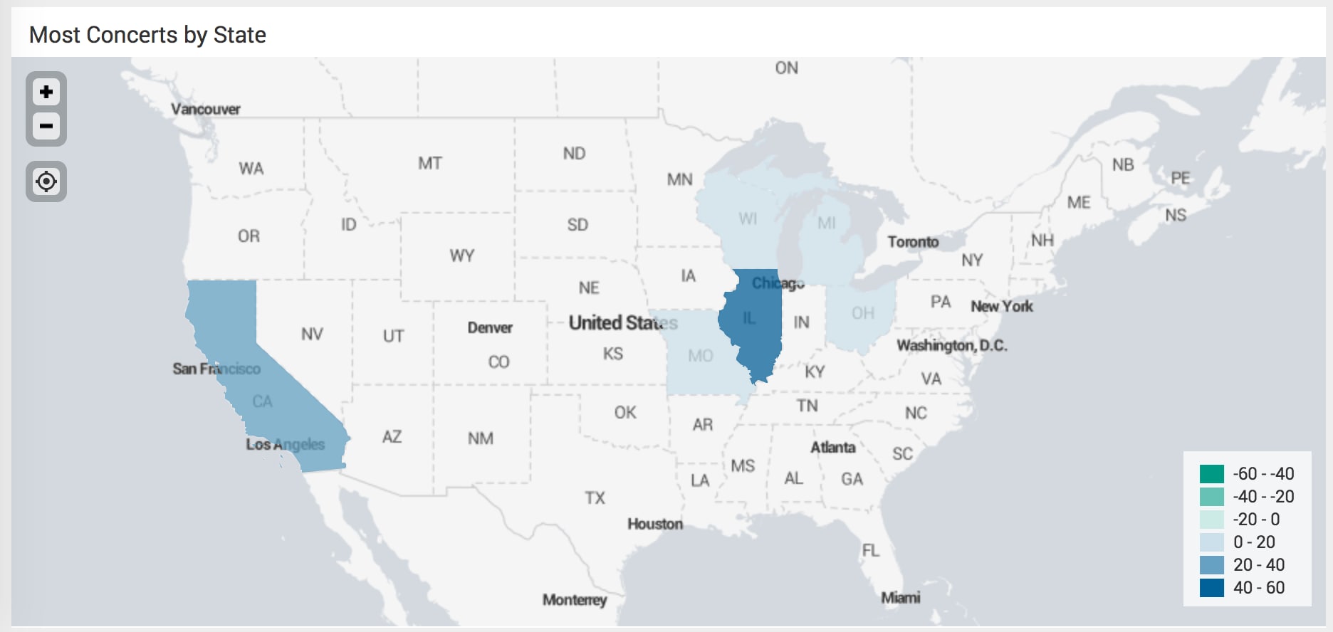

Let's make more fun visualizations, like a choropleth map because I have location data for these concerts!
The geo_us_states lookup included with the Splunk platform to use with the geom command expects the featureId to be the full state name, so I make sure my concert lookup data is prepared to work with that format and start writing my search. I can specify which field to use from the lookup as the featureId field that contains the state in my search.
| inputlookup concerthistoryparse.csv | stats count(state) by state | geom geo_us_states featureIdField="state"
I formatted the choropleth map so that it would focus on the United States and show the states with just a few shows as a discernible color. A little bit of viz-hacking brought to you by the latitude and longitude of Kansas City and a zoom level of 4. I played around with the available colors and tiles as well to find a look that fit what I wanted.

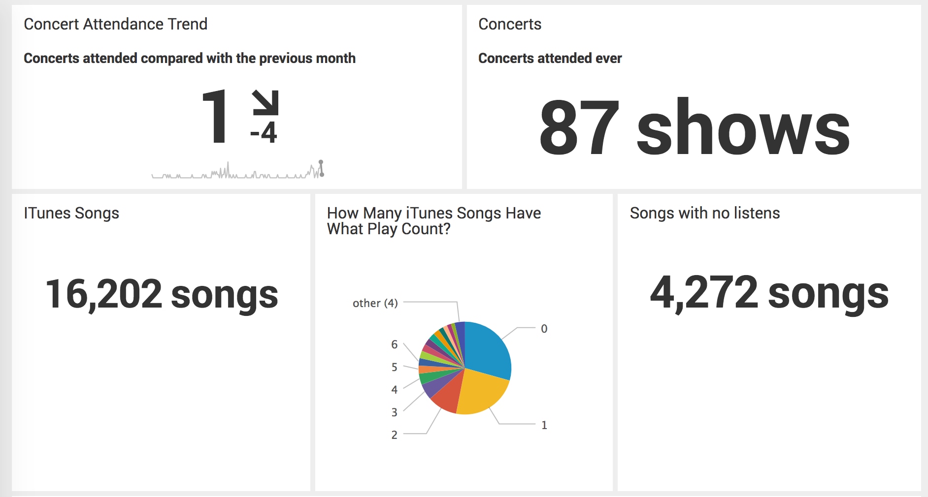

That was almost all of the fun visualizations I could think of. I set up some single value indicators to get some good statistics on my data. I wanted a concert attendance trending indicator, alongside the total count of concerts I'd been to; I also wanted to review the count of total iTunes songs alongside the count of iTunes songs I've never listened to. The pie chart showing the most common play_counts in my iTunes library make it clear: I haven't listened to nearly 30% of the songs in my iTunes library. Even worse, I've only listened to another 24% of the library just one time.

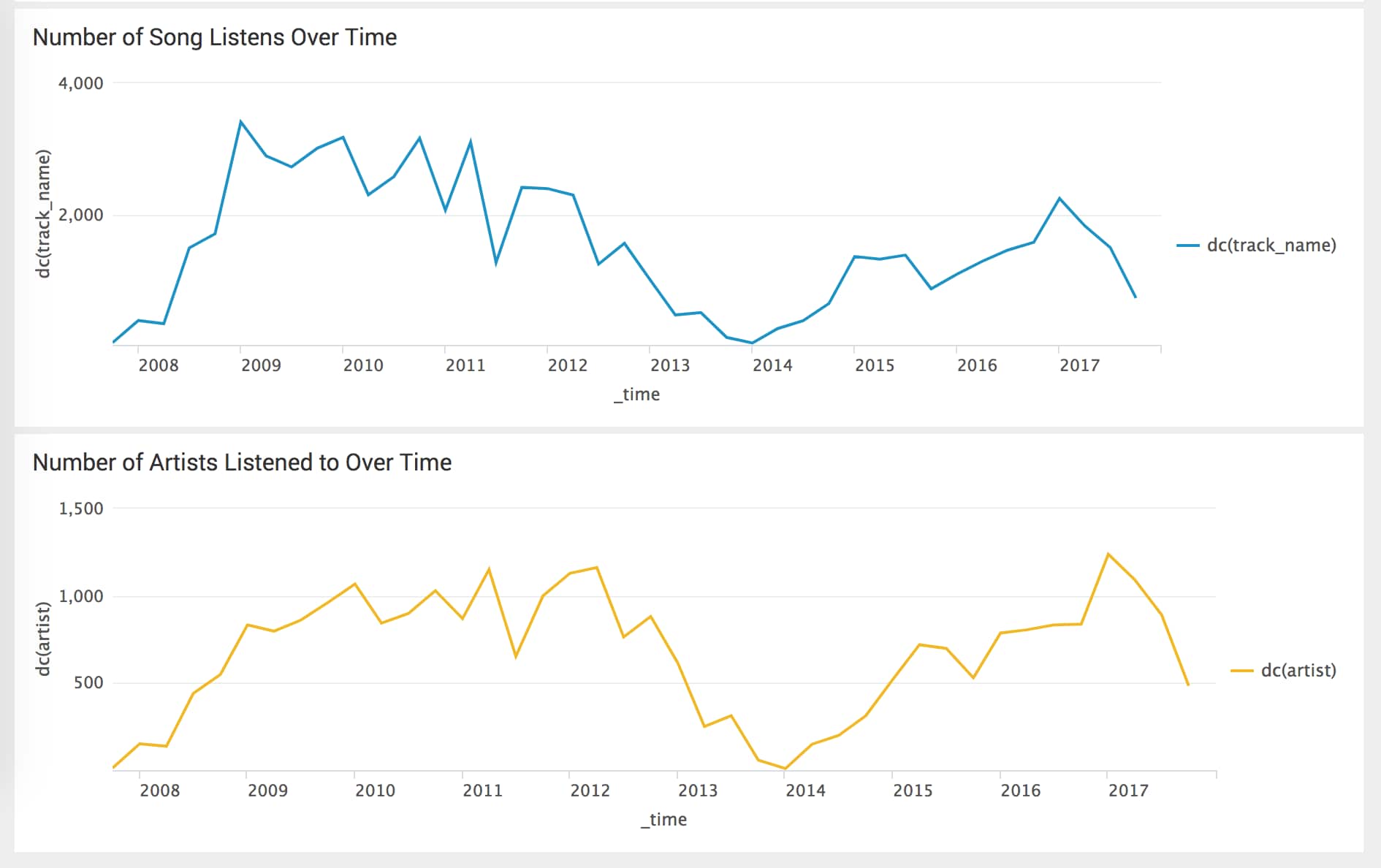

I wanted to figure out how my discovery and listening diversity was faring over time as well.
`lastfm` | timechart span=3mon dc(artist)
Working in a radio station in college meant that I was exposed to a lot of new music—something hard to replicate in other environments. However, by the looks of my data analysis, I'm doing okay again. Perhaps unsurprisingly, the distinct count of songs and distinct count of artists I've listened to over time hasn't been too different in terms of trend lines. The diversity of artists that I'm listening to nowadays is similar to where it was in 2010 and 2011 when I was working at the radio station, but the distinct count of songs is much lower, likely indicative of the fact that I've been busy doing things like working.

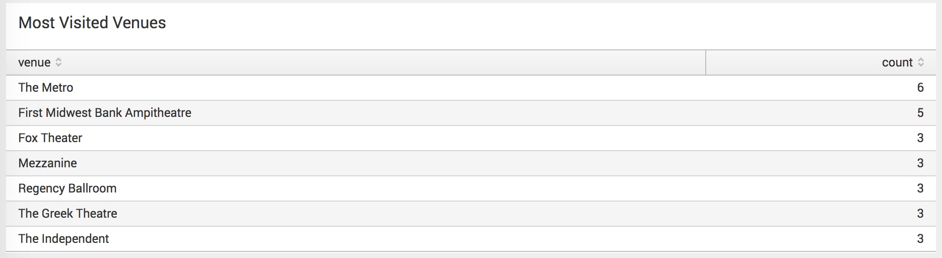

I took some more steps to analyze my concert data, figuring out which artists I've seen more than once and the list of most visited venues.
To make the list of most visited venues more interesting, I added a quick drilldown that would search the venue name in Google Maps.
<drilldown> <set token="venue_name">$click.value$</set> <link target="_blank">https://www.google.com/maps/search/$venue_name$</link> </drilldown>

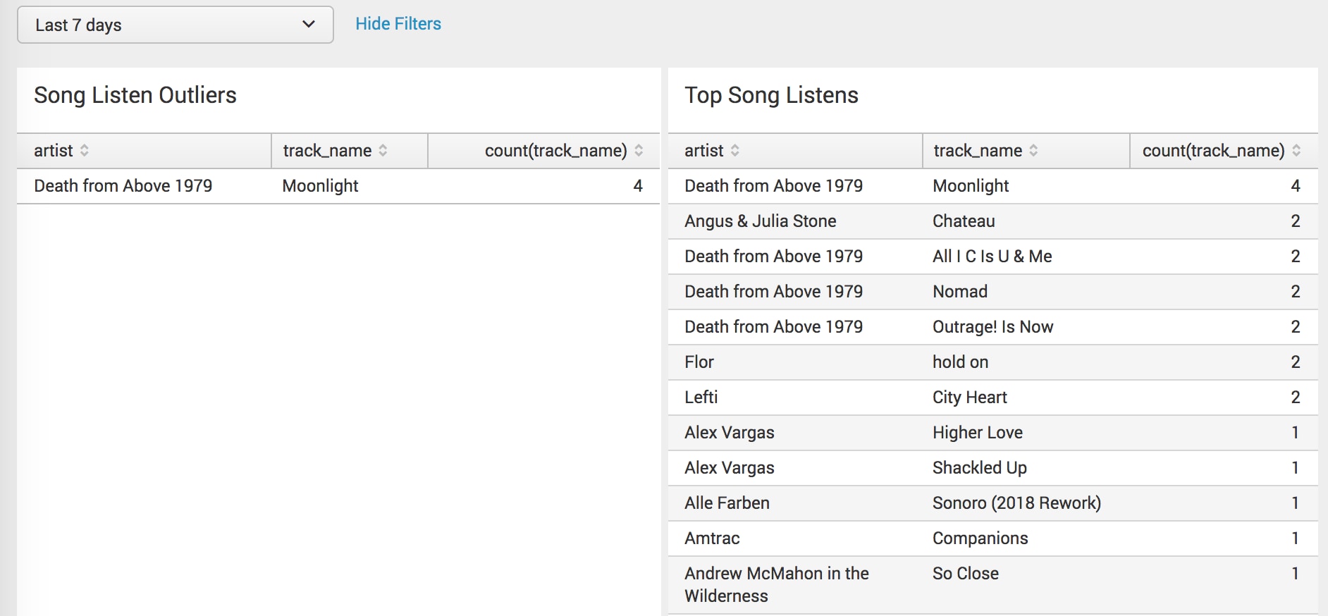

Using the assistants for detecting numeric outliers and detecting categorical outliers, I played around with getting interesting and understandable outliers. I ended up using the assistant to detect categorical outliers; I started with a basic search to identify track listen outliers in my data.
`lastfm` | stats count(track_name) by artist,track_name
Using the count(track_name) as the outlier field, I'm able to get interesting and understandable outliers. I open up the Data and Outliers table in search to figure out what else I can see that might explain why these are outliers.
I cleaned up the table and added some extra fields to make it prettier and limit it only to outliers.
`lastfm` | stats count(track_name) by track_name, artist | anomalydetection "count(track_name)" action=annotate | eval isOutlier = if(probable_cause != "", "1", "0") | where isOutlier=1 | table artist, track_name, "count(track_name)"
I put it on a dashboard next to a panel that shows the top song listens, then wire both of those panels up to the same time input so I can compare what the MLTK says is an outlier in terms of listens and how that compares with the top listens over the same period of time.
