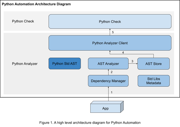

As we all know, the Python programming language is quite flexible so automatically inspecting Python code against a set of predefined security and quality criteria is not an easy task. Hence, our deliberate design for the Python Automation solution, which aims to automate Python code inspection, consists of both “Python Check” and “Python Analyzer”, as illustrated below.
At the top layer, “Python Check” is where all Python checks are managed and executed. These Python checks inspect code against relevant security and quality criteria such as file-system manipulation, insecure HTTP connection, thread security, etc.
Underneath, the layer for “Python Analyzer” feeds required app information to “Python Check”, and it contains the following parts:
  • Python Standard AST: An official Python Standard AST module, which is a powerful tool to parse Python code.
  • AST Analyzer: On top of Python Standard AST, a specific AST analyzer is built up to fit for use of Python code analysis.
  • Dependency Manager: It analyzes the dependency affiliation of Python files, which facilitates searching sensitive code patterns across files.
  • AST Store & Standard Libs Metadata: Utilities for Python code analysis.
  • Python Analyzer Client: An interface between “Python Analyzer” and “Python Check”.
Let’s take an example of Splunk DB Connect, and figure out how the Python Automation solution automatically inspects Python code during the app vetting process, as illustrated in the Figure above.
  1. All Python files in the app first enter Dependency Manager to analyze dependency relationships among the files/modules.
  2. Then, AST Analyzer analyzes the Python files in a topological order, namely, independent files are processed first and then dependent files come later.
  3. The analysis result from the step above is saved into AST Store.
  4. AST Store further delivers the analysis result to Python Analyzer Client.
  5. Finally, Python Check uses the analysis result to perform automated inspection, some important checks are listed as follows and check descriptions can be found out at AppInspect check criteria.
