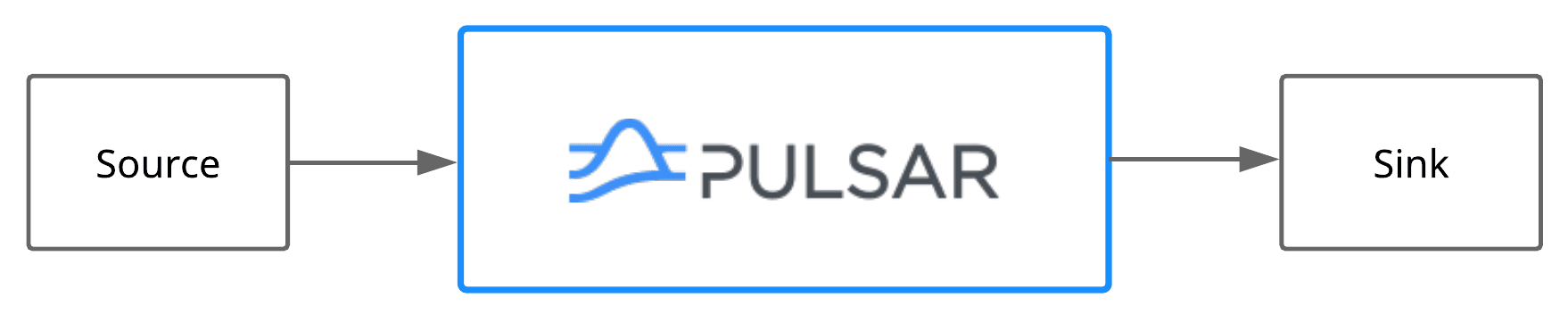

Let’s first define an application that ingresses data into Pulsar as a source and an application the egresses data from Pulsar as a sink.
Figure 1. Pulsar sources and sinks
A source is an application that ingests data from an external system into Pulsar, while a sink is an application that egresses data from Pulsar to an external system.  To be more concrete, a source will read data from an external system and write the data to a Pulsar topic, while a sink will read data from one or more Pulsar topics and write to an external system.

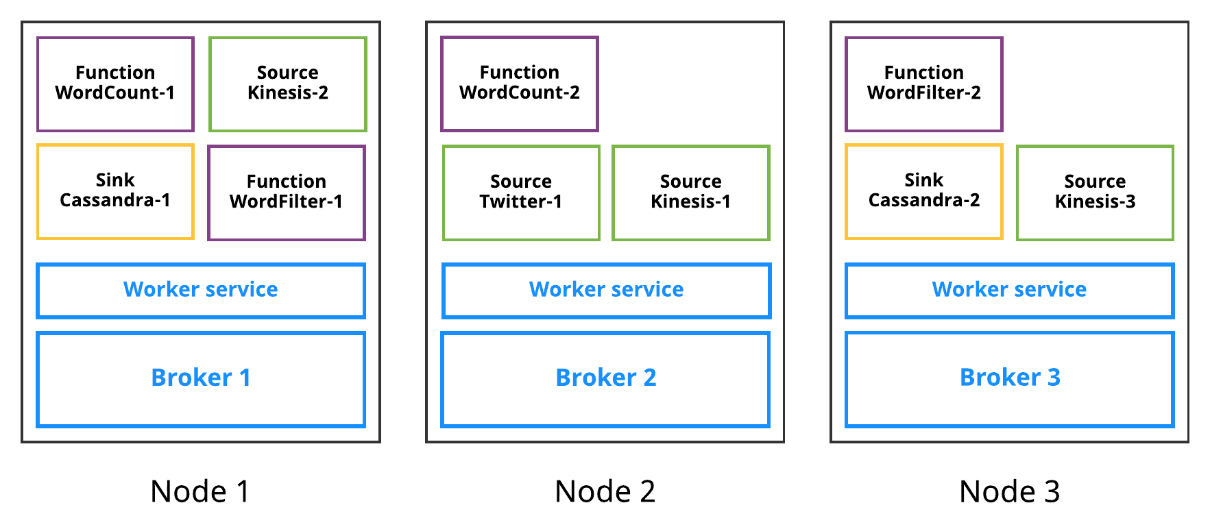

The Pulsar IO framework runs on top of the existing Pulsar functions framework.  Individual sources and sinks can run like any function alongside Pulsar brokers as shown in Figure 2.
Figure 2. Sources, sinks, and functions running on brokers
Thus, all the benefits of the Pulsar Functions framework is also available to to Pulsar IO framework i.e. sink and source applications.
