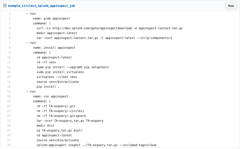

The next task was to build a job to automatically run AppInspect on every pull request for our TA-osquery. This was the end result:
Here, you can see that CircleCI executes three jobs: grab appinspect, install appinspect, and run appinspect. Let's unpack these a bit:
  • The job grab appinspect is straightforward. Using curl grabs its latest build and untars it under the ~/appinspect-latest directory.
  • Next, install appinspect uses pip to install the necessary tools and virtualenv. We use virtualenv to install appinspect and its dependencies.
  • Finally, run appinspect runs appinspect and returns an error if your app does not pass. It also prepares the repo code to ensure it does not return obvious errors.
