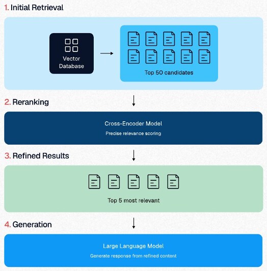

A reranker is the second-pass filter in an information retrieval (IR) system. It reorders documents from the first-stage retriever (semantic, keyword, or hybrid search) so the most relevant land at the top of the context window. Rerankers trade efficiency for effectiveness, applying heavier matching than a vector inner product across the candidates the retriever provides.
This image shows the two-stage retrieval process: the vector database returns a wide candidate pool, the reranker narrows it before generation.

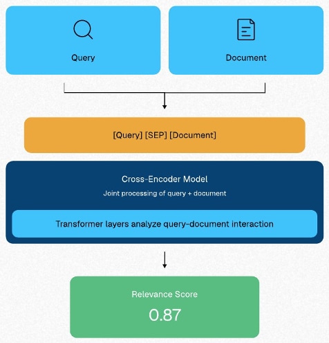

A cross-encoder scores query and passage together, so each candidate must be paired with the query and run through the model. Documents can't be embedded independently.
A cross-encoder processes the query and document together rather than embedding each independently.

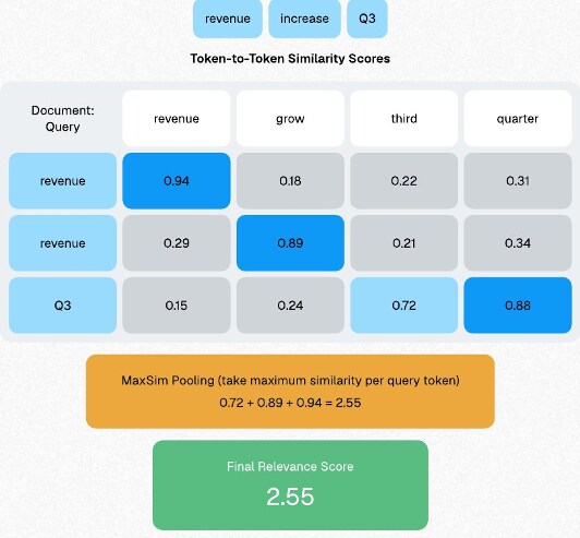

Multi-vector models like ColBERT encode query and document text independently into token-level vectors, then interact at scoring time. Pre-computed document representations reduce compute for large collections, and ColBERTv2 adds residual compression that shrinks the index while maintaining quality.
ColBERT computes token-level interactions between query and document at scoring time.

Matrix multiplication scores every query term against every document term, max-pooling keeps the best match per query term, and the sum ranks the documents.

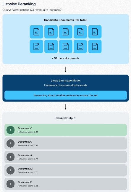

Listwise reranking processes all candidate documents together and returns a reordered list.
Candidate sets rarely fit one prompt, so RankGPT-style methods slide a window back to front; smaller steps bring modest gains but increase inference time.
