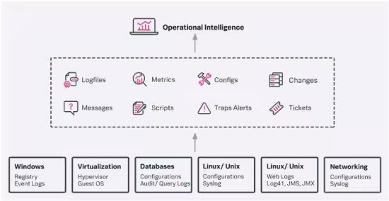

Operational intelligence
Operational intelligence targets the cybersecurity professionals who are responsible for conducting daily operations in a security operations center (SOC). It provides a more in-depth understanding of how attackers plan, execute and maintain cyberattacks and operations by understanding the attributes of adversaries like TTP used for cyberattacks.
Operational intelligence helps improve threat monitoring, threat management and incident response tasks. Since TTPs cannot be changed easily, operational intelligence lasts longer than tactical intelligence.
Still, there are challenges in accumulating operational Intelligence. For example, encrypted messaging apps like WhatsApp and Telegraph, used by attackers for communications, are not easy to access, and the language some threat groups use can be difficult to decipher.

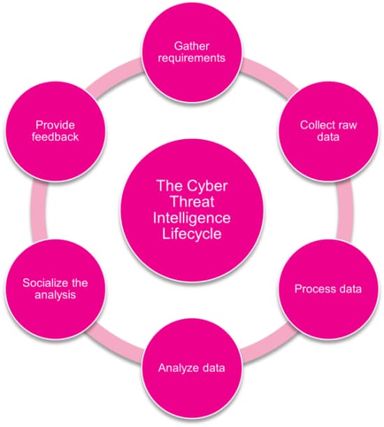

Stages of the CTI lifecycle
Threat Intelligence is not an end-to-end process; rather, it is a cycle that starts from gathering requirements to getting feedback. The intelligence lifecycle transforms raw threat data into actionable insights that help cybersecurity teams to deploy effective threat intelligence programs. It comprises six phases:
- Requirement gathering
- Collection
- Processing
- Analysis
- Dissemination
- Feedback
1. Gathering requirements
The first stage is gathering all the stakeholders' requirements for threat intelligence. This phase can be seen as a planning phase where you set goals for the CTI and the methodology you should follow. The typical tasks of this phase include:
- Defining the attack surface and the impact of a cyberattack.
- Identifying which areas of the organizations the CTI program must cover.
- Discovering the attackers and their motivations, and the required actions you’ll take.
2. Collecting raw data
After identifying all the requirements, the collection stage gathers the required data to satisfy the goals and objectives set in the first phase. To complete this stage, organizations need to determine the sources of threat data based on the defined goals and objectives. The following data sources usually include:
- Publicly available data sources like news sites, forums and blogs
- Network traffic logs
- Social media sites
- Threat data feeds provided by dedicated cyber security firms
- Data from subject matter experts and interviews with relevant stakeholders
- Cyber Counterintelligence (CCI) sources like passive DNS monitoring, sinkholes and honeypots
- Analyzing malware to understand their origin and impact
3. Processing data
The collected raw data is not suitable for use in the threat analysis stage. Therefore, the next stage is transforming the raw data into an easily analyzed format. Depending on the data type, processing tasks include data normalization, sorting, sampling, validation and aggregation.
The method of data transformation depends on the data source. For instance, network traffic logs may have to be extracted with regular expressions (regex) for certain terms and news, and blog sites from foreign countries must first translate into their native language. If you collected data from interviews, you’ll have to carry out appropriate validations.
(See how to use RegEx and Splunk for threat hunting.)
4. Analyzing data
The next phase is searching, interpreting and analyzing the formatted data to meet the goals and objectives defined and answering the questions identified during the requirement-gathering phase.
The analysis reveals threat patterns and potential security impacts on the organization. Data analysis techniques include statistical data analysis as well as hypotheses-based analysis.
The data analysis helps provide actionable recommendations on achieving organizational threat intelligence, like…
- What investments the organization should increase
- Actions to take on immediate threats
- If any particular threats should be investigated, etc.
5. Disseminating or socializing the analysis
After completing the analysis according to the organization's requirements, circulate these reports to relevant stakeholders in a format that lets them easily decipher their contents.
Again, different stakeholders have different requirements regarding the analysis. Before sharing the information, identify stakeholder preferences for the report format and the information the analysis should contain. Best practices here include:
- Concisely presenting the results and recommendations.
- Avoiding complicated technical jargon. (Remember, you want their buy-in!)
- Presenting the data in charts and graphs so stakeholders can easily interpret the results just by looking at them.
6. Providing feedback
The last phase of the threat intelligence lifecycle is getting feedback for the threat intelligence report presented to the stakeholders. Stakeholders will inform you if they need changes to the report, whether the analysis meets the organizational goals and objectives, the frequency they would like to obtain the threat intelligence reports, etc.
Any changes to the report indicate particularly where the threat analysts should focus. Therefore, feedback is essential to make threat intelligence improved and successful.
Reminder: CTI does not stop here. CTI is not a linear process that finishes within one iteration. Rather, CTI is an iterative and continuous process where each cycle helps improve the organization’s threat intelligence program.
