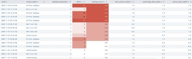

This search will allow you to identify the services that have the most unusual volumes of alerts, as shown in the table below.

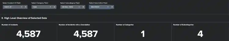

If you then select the relevant fields form the dropdown as per the image below you should get a report on the data. Once the panels have populated select the single threshold from the dropdown and click on the identify frequently occurring types of tickets button.
Smarter Noise Reduction in ITSI
On the next dashboard, you may want to modify some of the selections depending on the groups that are identified. I have gone with the defaults, except for choosing not to use the description statistics for the clustering. Once you have checked over the groups and made sure you are happy the alerts are being grouped sensibly save the model and move onto the manage smart groups dashboard.

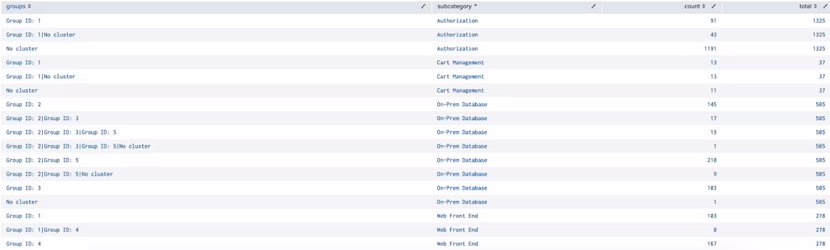

This will produce a very similar table to the one we saw for the sourcetypes above:
What we have now, however, is something that tells us about the expected alert descriptions for each service that we have some correlation searches against, and we’re going to persist this as a lookup called expected_itsi_alert_groups.csv.

This search will present you with a result set that has an anomaly score calculated as the sum of our outliers multiplied by the likelihood of the sourcetype and alert group combinations in the data.
