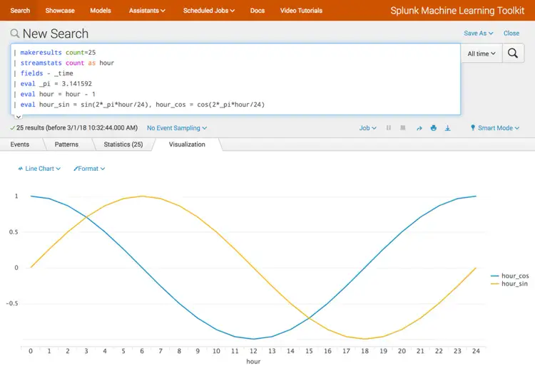

Another approach is transforming the time features so that hour 1 is more similar to hour 23 and both of them are equally less similar to hour 12. To represent the cyclical characteristic, we express date_hour with two features—flexing your trigonometry muscles—sin(date_hour) and cos(date_hour). Let’s take a look at the following chart. The cyclical characteristic is obvious now. By looking at the blue line, we can tell that after the transformation hour 1 and 23 are more similar now and both are different from hour 12.
Also, the blue line says that hour 6 and 18 are similar, which can be wrong in the context of a website’s traffic. That’s why we need the second transformation to introduce the dissimilarity between 6 and 18.

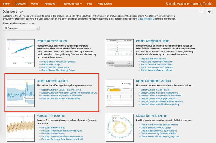

But how do we set the static thresholds? This is the part that needs some investigation. Let's take the search that calculates the residual to the Detect Numeric Outliers assistant.
Splunk Showcase Detect Numeric Outliers

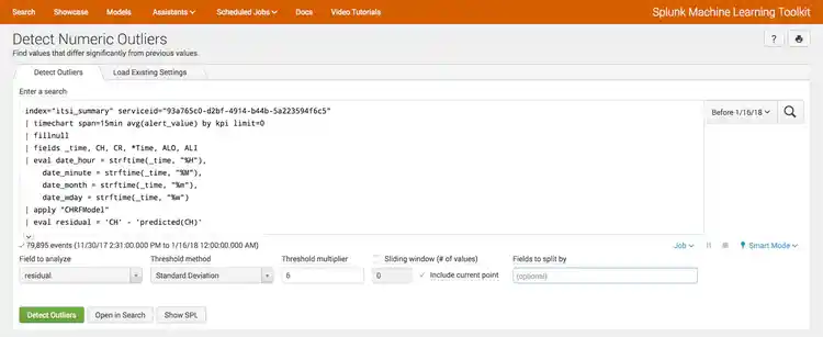

After running the search in this assistant, we choose residual from the Field to Analyze dropdown menu. This menu gets populated based on the fields in the search result. We keep the threshold method to be Standard Deviation and set the Threshold Multiplier equal to 6 (for really extreme anomalies). Also we keep the Sliding Window box unchecked, because we are looking for static thresholds.
After clicking on Detect Outliers, the assistant generates multiple charts showing the outliers in various ways.
We are happy with the thresholds and the anomalies that are detected. But how can you be sure your thresholds are good enough? There’s no easy answer to this question. You need to investigate. If you detect too many anomalies, it might mean that your false positive rate is high. To avoid that, you need to choose a larger threshold multiplier. Choosing a very large threshold multiplier can also cause high false negatives. So, the path to find the right threshold is finding if the anomalies that you find make sense to you and that the anomalies that you know of do also get detected.
Alright, looks like a higher threshold of 4.5 and lower threshold of -4.5 work for us. One last note that we could make a similar guess on what the thresholds should be by just looking at the residuals histogram.

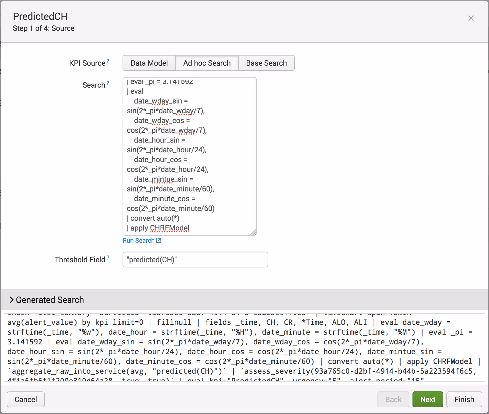

Under the KPI tab, we choose Generic KPI from the 'new' dropdown menu. Let's call this KPI PredictedCH. The following search applies the CHRFModel model on the data and produces a new field called 'predicted(CH)'.
index="itsi_summary" serviceid="93a765c0-d2bf-4914-b44b-5a223594f6c5"
| timechart span=15min avg(alert_value) by kpi limit=0
| fields - Call* ServiceHealthScore
| fillnull
| fields _time, CH, CR, *Time, ALO, ALI
| eval date_hour = strftime(_time, "%H"),
   date_minute = strftime(_time, "%M"),
   date_month = strftime(_time, "%m"),
   date_wday = strftime(_time, "%w")
| apply CHRFModel
