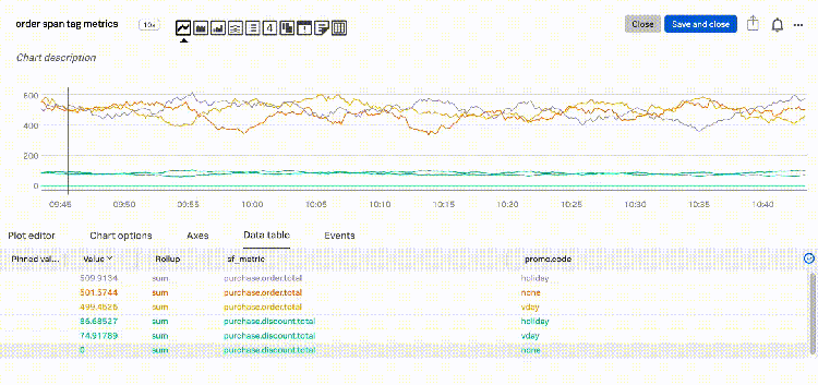

This is done by leveraging the attributes attached to these types of telemetry. A source_attribute designates which attribute the numerical value for a new metric would come from. In our use cases, we’ll be using source attributes called order.total and discount.total from our spans to denote the total purchase before discount and the discount applied to the purchase. Additionally, we’ll leverage the attribute from promo.code to keep track of which discount was applied for any given time series by attaching it as an attribute to our new metrics derived from the source_attribute.
Figure 1-1. Our newly created metrics for purchase.order.total and purchase.discount.total, along with a dimension attribute for promo.code.

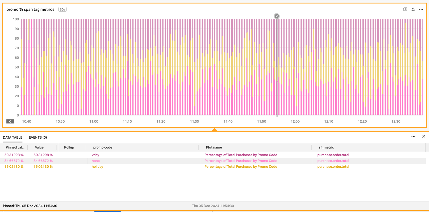

We can now track the total revenue against our application and infrastructure metrics and quickly correlate dips in revenue to incidents or changes in the environment. Even further, as a business level example, if our friends in marketing wanted to know what percentage of total sales is using a given promotion code in real time we can quickly chart that. We can also use this data to tie infrastructure and application performance data to critical business metrics. With that same charting method we could create an alert to let us know when promotions or non-promoted sales reach an unusually low level. In Figure 1-2 you can see what this sort of calculation might look like in practice.
Figure 1-2. With our newly created metrics for purchase.order.total along with a dimension attribute for promo.code we can quickly see the percentage of purchases using any given promotion.
