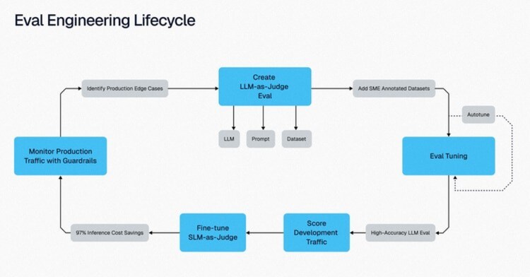

SME review in the eval lifecycle
SME refinement is stage two of the eval engineering lifecycle: label a few hundred examples, sample the cases worth an expert's time, review the disagreements, extract the rule, re-measure. That loop turns a generic judge into one that encodes your domain.
