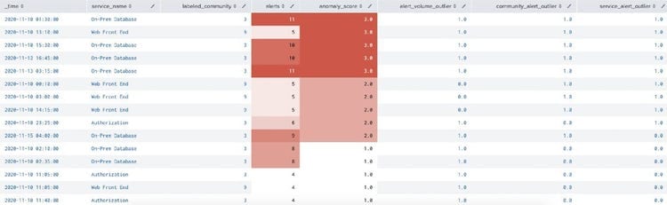

This search will allow you to identify the services that have the most unusual volumes of alerts, as shown in the table below.

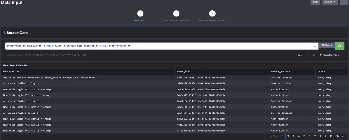

2.2 Alert Description Analysis
Here we’re going to use the Smart Ticket Insights app for Splunk to determine the likely alert descriptions in our data. If you want more details on the app, feel free to read up on it here. We’re going to start with a simple search to return the alert descriptions, IDs and services from our correlation search index.
Smarter Noise Reduction in ITSI

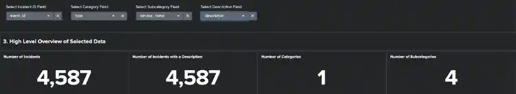

If you then select the relevant fields form the dropdown as per the image below you should get a report on the data. Once the panels have populated select the single threshold from the dropdown and click on the identify frequently occurring types of tickets button.
On the next dashboard, you may want to modify some of the selections depending on the groups that are identified. I have gone with the defaults, except for choosing not to use the description statistics for the clustering. Once you have checked over the groups and made sure you are happy the alerts are being grouped sensibly save the model and move onto the manage smart groups dashboard.
