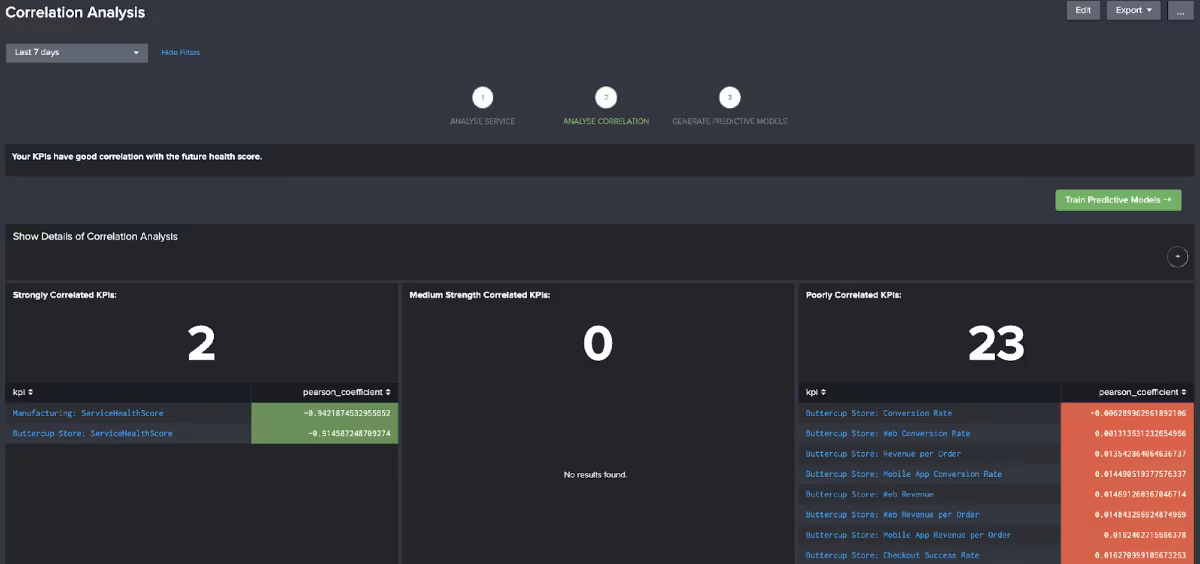

Identifying the KPIs that are correlated with the future health score
After inspecting the service you can click on the Analyze Service Health & KPI Correlation button to move to the next stage of the workflow. On this dashboard, each KPI that the service relies on will be compared with the future health score (i.e. the health score 30 minutes ahead of the KPI metrics) to determine how strongly correlated the KPI is with the health score.
The results will be split into strongly correlated KPIs, medium strength KPIs and weakly correlated KPIs. Provided there is some decent correlation in your data feel free to click on the Train Predictive Models button, which will take you to the next stage of the workflow.
If you don’t have any strong or medium strength correlations in the data then it is highly likely you won’t be able to create a good prediction in ITSI. If this is the case you can click on the View KPI Relationships button you will be taken to a further dashboard that will make some suggestions about the KPI importance settings in your ITSI instance.
Correlation Analysis

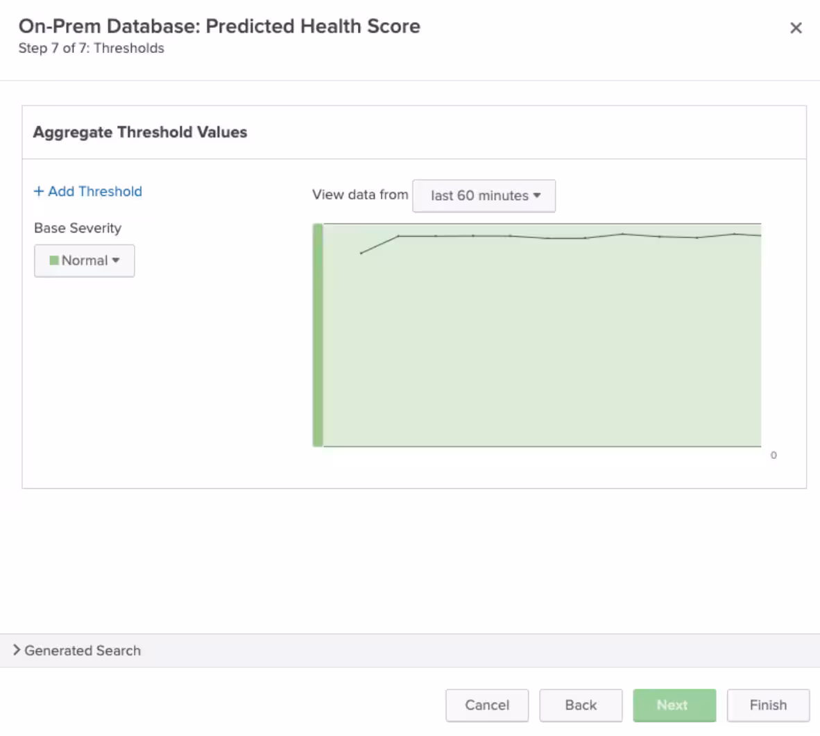

Include your predictions in ITSI
Predicted Health Score
Once you are happy with the results and have the appropriate search you can then take the search and include it as another KPI for the relevant service (in this case it would be ‘On-Prem Database’).
To do this browse to ITSI > Configuration > Services and select the service you have just trained a model for. On the KPIs tab create a new Generic KPI and use the search that the predictive workflow generated with the predicted_hs as the ‘Threshold Field’.
Once the KPI is activated don’t forget to set the KPI importance to 0 on the settings page for your newly created KPI - you don’t want your prediction to affect the current health score!
