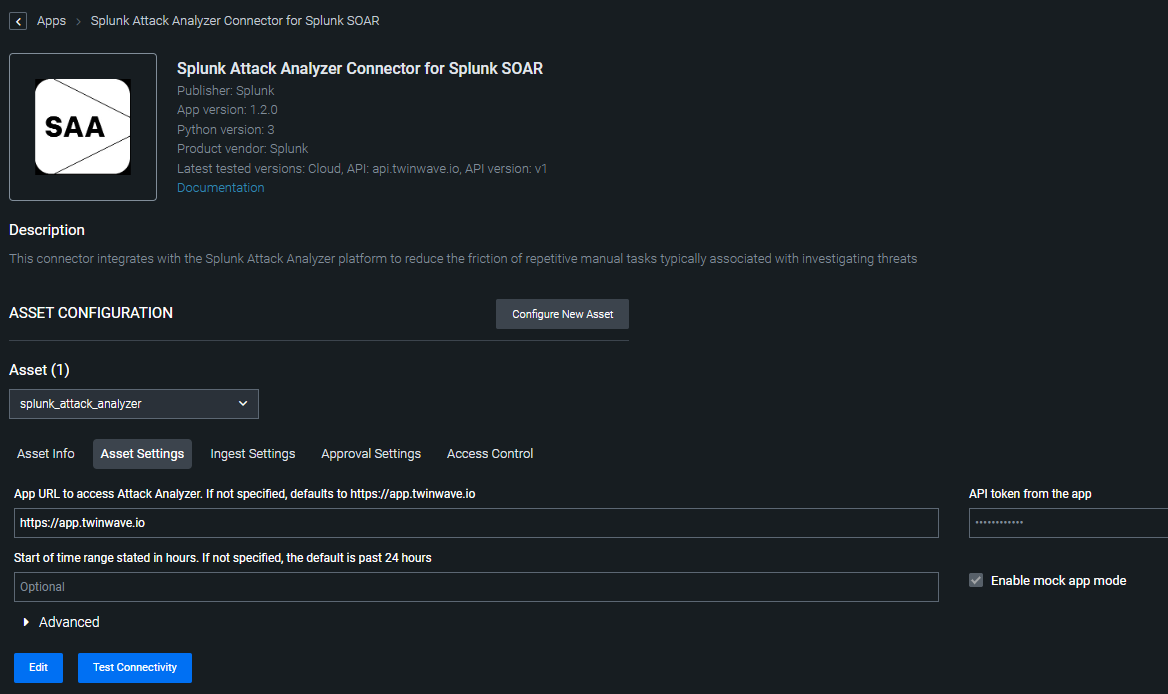

The Splunk Attack Analyzer Dynamic Analysis Playbook is an input playbook that accepts url link, domain or vault_id (hash) to be detonated using the Splunk Attacker (SAA) API connector. This process aligns with Mitre D3FEND’s Dynamic Analysis technique which involves executing or opening a file in a sandbox environment to see if the artifact in question is a malicious program or if it attempts to exploit another program.
Getting Started
Using the Playbook
  1. From the artifacts tab, select the artifact(s)that you want to investigate.
  2. Select the “Run Playbook” option for the nav bar on the upper right.
  3. Search for Splunk_Attack_Analyzer_Dynamic_Analysis in the search bar and then select the playbook.
  4. Click the blue “Run Playbook” button in the bottom right of the window.
  5. Running the playbook will cause Splunk Attack Analyzer to perform detonation analysis on the selected URL and vault_id values of the selected artifact(s).
  6. Once this process is completed, Splunk Attack Analyzer generates a global report, a per observable sub-report and provides a normalized score which can be viewed in Splunk SOAR.
