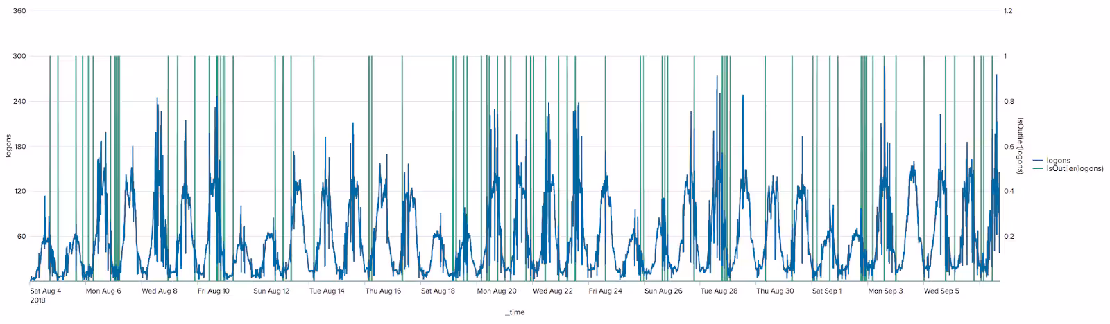

This fit command will also spit out a few extra values: IsOutlier(logons) and BoundaryRanges. Don’t worry too much about BoundaryRanges (that’s to do with the ranges used to find outliers), but the IsOutlier value will tell you if the data is an outlier or not.
cyclical data set
Now it just looks like we have a load of outliers? Don’t worry, we’ll show you how to tune the volume of outliers, but before we look at refining the number of outliers let’s have a quick look at what the model has produced.

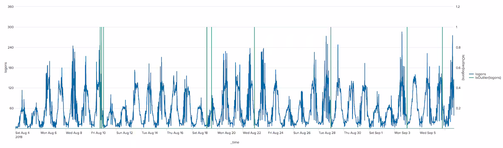

| apply df_cyclical_business_processes threshold=0.001
| table _time logons IsOutlier(logons)
cyclical data
Note that we have used the threshold argument here and have significantly less outliers than before. That is because the threshold tells Splunk what range to look for – 0.001 means look for anything in the least likely 0.1% of the data.

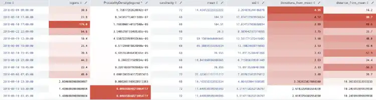

Finally, let’s bring it all together and use the model summary to enrich the results with added context using the search below.
| inputlookup cyclical_business_process.csv
| eval _time=strptime(_time, "%Y-%m-%dT%H:%M:%S")
| bin _time span=15m
| eval HourOfDay=strftime(_time, "%H")
| eval DayOfWeek=strftime(_time, "%A")
| apply df_cyclical_business_processes threshold=0.001 show_density=true
| where 'IsOutlier(logons)'>0
| eval HourAndDay=HourOfDay." ".DayOfWeek
| join HourAndDay [| summary df_cyclical_business_processes | eval HourAndDay=HourOfDay." ".DayOfWeek | table HourAndDay cardinality mean std]
| table _time logons ProbabilityDensity(logons) cardinality mean std
| eval distance_from_mean=abs(logons-mean), deviations_from_mean=abs(logons-mean)/std
MLTK logons
With this search we have filtered our results to only show the outliers, added in the mean, standard deviation and cardinality data from our model summary. Additionally, we have performed some calculations to determine how far our number of logons is from the mean and how many deviations away from the mean they are as well – this tells us a bit more about how extreme the outlier is. We’ve also used the show_density=true option to add in the probability density associated with the logons value. All of this data can be used to perform additional filtering or tuning of the data so that you are only alerting on the most extreme of outliers.

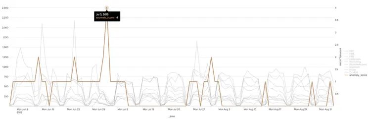

What if I have Multiple Variables?
Now that you’ve seen how to find anomalies on a single variable it’s fairly easy to find them in datasets that have multiple variables – all you need to do is fit and apply more DensityFunctions!
This time we’re going to pick on a different dataset with a few variables in the MLTK, the app_usage.csv dataset. Because this dataset isn’t as densely populated as the cyclical_business_processes.csv data we’re going to break out our anomaly detection by weekdays and weekends rather than hour of day.
| inputlookup app_usage.csv
| eval _time=strptime(_time, "%Y-%m-%d")
| eval Weekend=if(DayOfWeek="Saturday" OR DayOfWeek="Sunday","Yes","No")
| fit DensityFunction ERP by "Weekend" into df_erp as outlier_erp
| fit DensityFunction Expenses by "Weekend" into df_expenses as outlier_expenses
| fit DensityFunction HR1 by "Weekend" into df_hr1 as outlier_hr1
| fit DensityFunction HR2 by "Weekend" into df_hr2 as outlier_hr2
| fit DensityFunction ITOps by "Weekend" into df_itops as outlier_ITOps
| fit DensityFunction OTHER by "Weekend" into df_other as outlier_other
| fit DensityFunction Recruiting by "Weekend" into df_recruiting as outlier_recruiting
| fit DensityFunction RemoteAccess by "Weekend" into df_remote_access as outlier_remote_access
| fit DensityFunction Webmail by "Weekend" into df_webmail as outlier_webmail
| eval anomaly_score=0
| foreach outlier_* [eval anomaly_score=anomaly_score+<<FIELD>>]
Cyclical density function
You can see that we have applied a DensityFunction algorithm to the app use metrics for a range of different applications and are then summing the outlier values for each. Alternatively, you could enrich your results and generate an anomaly score from another combination of metrics, such as probability density, distance from mean or deviations from the mean.
If you’ve been following along with the blog you may notice that your results differ a little bit from the chart here, so a challenge task is to modify the thresholds of your searches to see if you can replicate the chart. As a clue check out the apps that have the highest variance and consider increasing the threshold to find anomalies against the number of logons. Finally, as another challenge – do you think it’s possible to find all the anomalies using a single fit command? Hint: the untable command might be useful for this…
