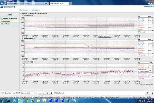

Output from a data logger on a PC. (Source)
The sensors collect data, the memory stores it, and the microprocessors process the data, allowing users to retrieve the data from the memory for analysis and decision-making.
