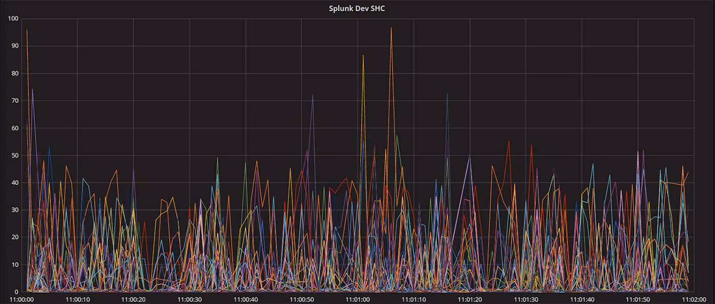

Before & After To illustrate the benefit of schedule skewing, here is one “before” vs. “after” scheduler performance chart.
The thing to notice is that the majority of searches are running every minute at the top of the minute saturating the network.
Here is the “after” schedule performance chart.
The thing to notice is that the searches are now much more evenly spread over time thus reducing the network load.
