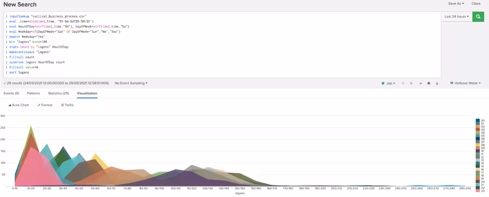

By breaking this down even further and focussing purely on the weekdays we can now see that each hour of the day has a nice distribution centred around a single point.
Exploratory Data Analysis for anomaly detection

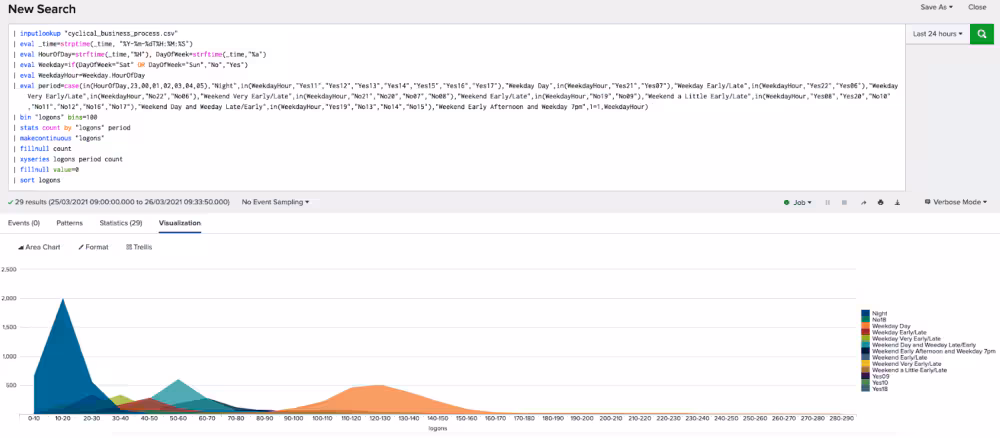

Maybe we have split our data down to finely, however, as many hours of the day appear to have very similar behaviour. We can add in a case statement to calculate a period now by visually examining each of the hourly histograms, and it is this period that we will use to determine the thresholds for detecting anomalies. Essentially after originally breaking our data down into hourly intervals we are now selecting more specific time periods by combining hours with similar behaviour together.

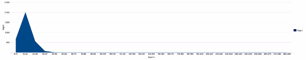

For data that shows some kind of skew to one side than using the DensityFunction algorithm in the MLTK is a better approach. Our Night period histogram is a good fit for this approach – being quite closely centred to zero and having a long tail running out into the hundreds.
