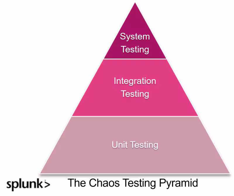

Chaos testing pyramid
The Chaos Testing Pyramid starts from the bottom (the foundation) with unit testing of isolated components, progresses to integration testing to check how these components interact, and finally proceeds to system testing where the whole system faces real-world chaotic scenarios.
This approach identifies vulnerabilities across all levels and helps to increase system resilience and fault tolerance.
