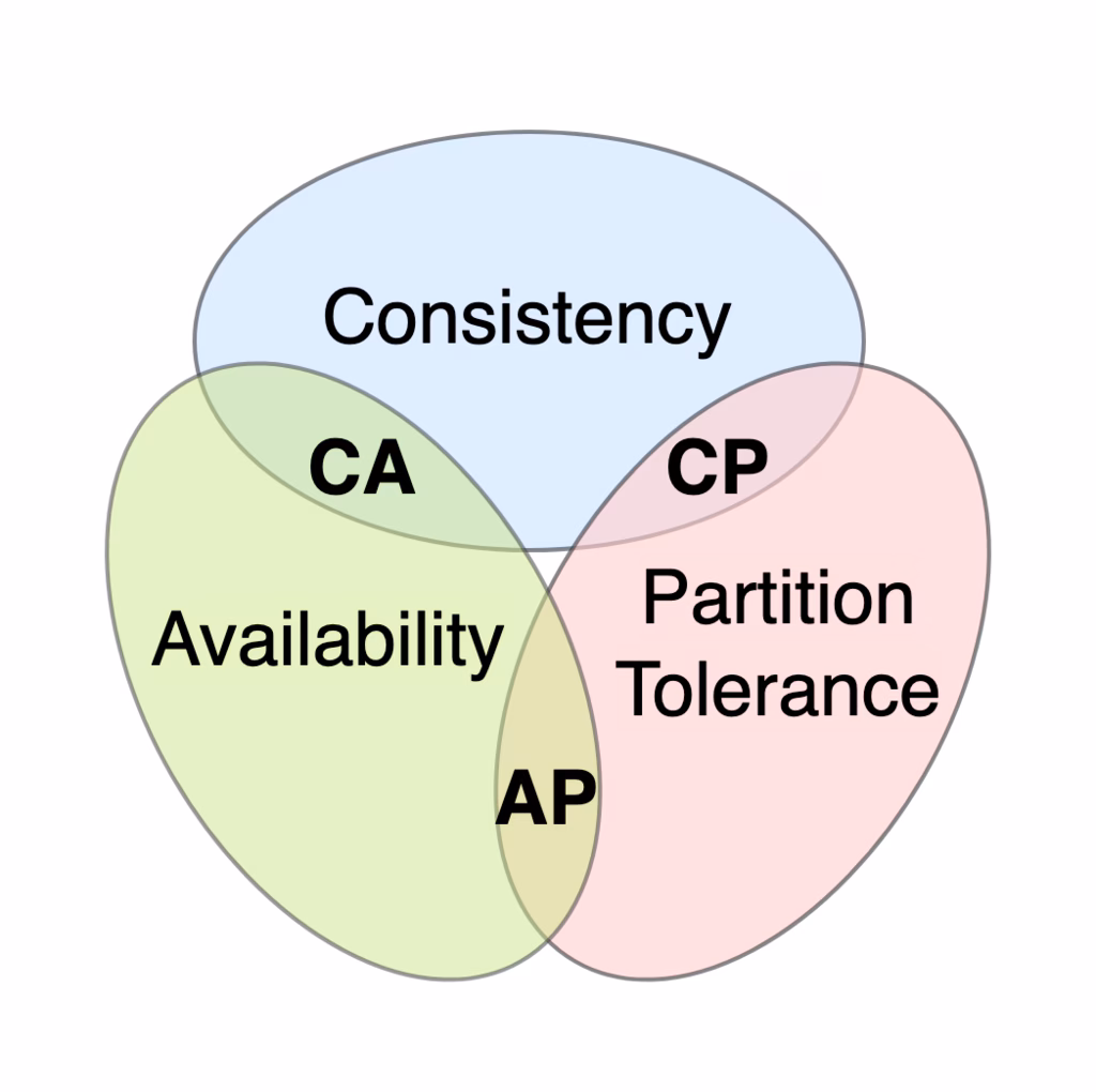

CAP theorem trade-offs
As we discussed, the real gist of the CAP Theorem is that it is challenging for a distributed system to simultaneously achieve all three characteristics — consistency, availability, and partition tolerance — at their maximum level.
Therefore, we have to prioritize two characteristics compromising on the third one. This leads to three primary trade-offs.
Be wary of oversimplifying these three compromises, however. In practice, the trade-offs are more nuanced. System designers frequently make dynamic adjustments based on the specific needs and circumstances of their systems.
Cap theorem graph
(Image source)
CP systems: Consistency & partition tolerance
In a system where Consistency and Partition tolerance are prioritized, the system makes sure that the nodes in the network have a constant view of the data, even during network disruptions (aka network partitions).
This means that when a value is written to one node, the value will be updated in all the other nodes.
However, CP systems may compromise on availability, meaning that some data might not be accessible in the event of a network partition.
CA systems: Consistency & availability
CA systems prioritize a constant view of the data and ensure the availability is high under normal operating conditions. This means that every request made to a (non-faulty) node in the system must return either a successful or a failed response.
However, CA systems may struggle with network partitions, potentially becoming less available or exhibiting lower performance during such events.
In reality, pure CA systems are rare. That’s because pretty much every distributed systems must handle network partitions to some degree.
AP systems: Availability & partition tolerance
AP systems prioritize availability and partition tolerance, rather than strong consistency.
This means that the system always aims to process queries and provide the most recent available version of information, even if it cannot ensure it is completely up-to-date due to network partitioning. In such systems, temporary discrepancies in data versions among different nodes are acceptable, with the primary goal being to ensure high availability.
